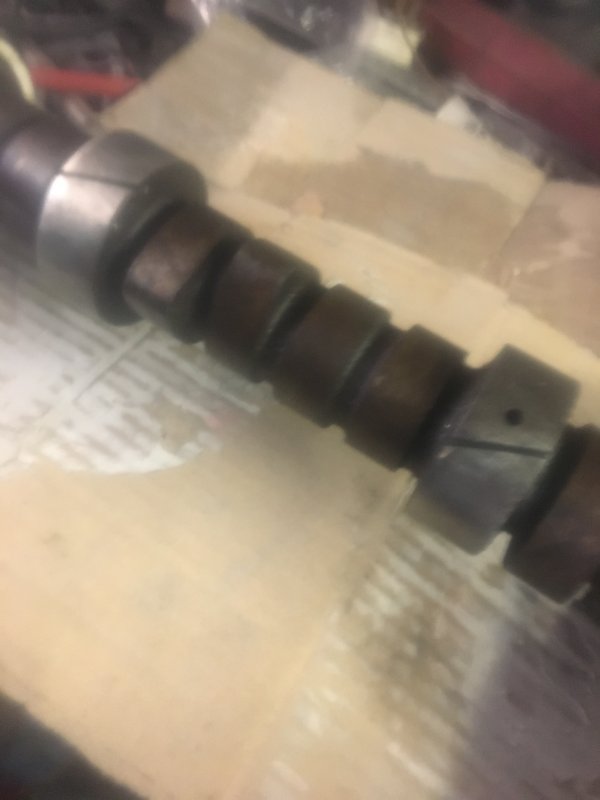

Has anyone had any problems with MAHLE bearings?
I have ordered some cam bearings from rock autos, and they seem way too big and they rattle around on the cam.
I have made a short vid if anyone wants to see

if this is based on taking out of box and trying against a cam journal then
they might rattle now
but may not once squashed into the hole,
and remember they are all different sizes front to back
big at front and smaller at the back
other way round you'd not be able to put the cam in
match each bearing to its journal and see if it fits better
if they are in the block they must be in the right position cos they usually don't fit in the wrong place, well they don't on a long 6 cylinder which uses the same bearings bar 1 or they are numbered or something.
** remebered... they only fit on the tool 1 way in the correct order, draw lines in felt pen line em up get out the mallet**
and it would imply an issue with them or the cam
BUT sometimes rockauto gets it so very very wrong...

"I’ve never heard of oversize Cam bearings, I can only assume they have sent you the wrong ones. If that’s the case, quite a coincidence that the O/D was the correct size.
Can you cross reference the part number from the box they came in, to verify what you have""
I must admit I cant find any over size ones
Ive not fitted them yet, as with this build . i have now figgerd nothing is at it seams
Spent over an hour the other day scrolling the net, and yep supplied correct .I did get them from rock autos but summet list the same numbers .
if this is based on taking out of box and trying against a cam journal then they might rattle now
The ones taken out are a lot better fit, even though badly worn
if they are in the block they must be in the right position cos they usually don't fit in the wrong place,,
Not fitted yet
and it would imply an issue with them or the cam, I have tried them on two cams, both rattle
I must say Rock Autoes have been great!
I told them, and they sent me a new set out strieght away
But alas these dont fit either

the cam bearings you took out of the block are already compressed to the size of the hole they were in.
the ones out of the box brand new have not been compressed so they will be bigger When Dry and than when installed
fitting to the block compresses them to a slightly smaller diameter inside and out we are talking a fraction just enough to take a sloppy fit to a fit with nearly minor resistance
so unless the clearance is massive the gap will be removed by installation and application of assembly lube and later oil
but if they are rattling like curtain rings on a curtain pole you have an issue! If they are just a little bit clicky when new and dry on a brand new cam journal that will be gone when they are squished into the hole.
in fact some have the other problem
they can't get the cam into a bearing that fitted out of the box but is too small when installed in the block

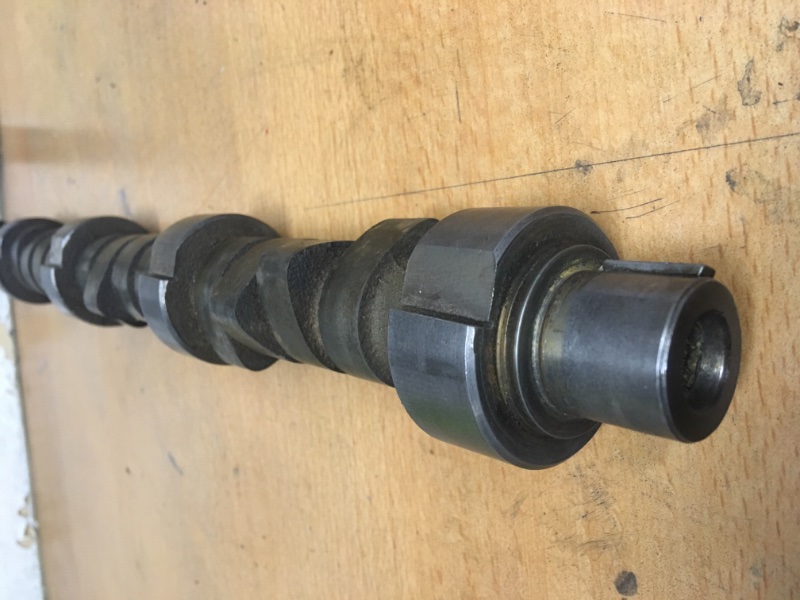

When you change cam bearings you need to use an old cam to ream them to size, they will be too tight otherwise.

Fitted them all is good , I fitted just one and checked it , and you were rite. It sqished it up

Thanks BlueBlue wrote: Fri Jan 08, 21 3:19 pm When you change cam bearings you need to use an old cam to ream them to size, they will be too tight otherwise.
I had read this and yes its a bit tight, but I can turn it with a spanner. As you said stick and old cam in there first
Re: MAHLE cam bearings too big
I'd say if you can't turn it easily with the sprocket bolted to it it's too tight. You are not just reaming the bearings to size, you're also ensuring they are in line.
