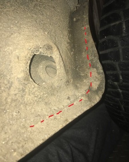

morgan
Posts: 4262
Re: 68-70 Charger trunk extensions
Post by morgan »
Well I had a crawl around; its quite tricky to see (bits of mud, grass and melty-rubber) but I scraped a bit off and it looks like mine doesnt actually have the double-lip like your pic. Far as I can see they cut off the old extensions (cut the rotten bits out I guess) and then put the new quarters on, tacked them together and sealed (see red dotted line) But there is no gap for anything to flow out anyway; not that I can see. Perhaps its a single skin/double skin thing ? Sorry Matt - tried ! (see pics)
