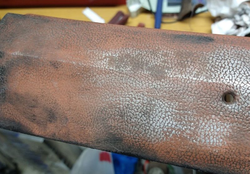

This is the interior header on my convertible - its a metal stamping with a grain to resemble the plastic parts. I stripped it decades ago at the sandblaster at work cos it's too big for mine, and painted it. Now it has some rust spots from being stored in the roof of my garage :x
Obviously sanding doesn't get into the grain. Any thoughts on an easy way to strip it and get the paint out of the grain, without removing metal. I tested a strip disc, scotchbrite wheel, fine brass wire brush (works but VERY slow). I also stripped the main surface paint just using thinners (I had it to hand).
Paint stripper is one obvious possibility - what do you think (and if so, are there any that actually work these days?)
