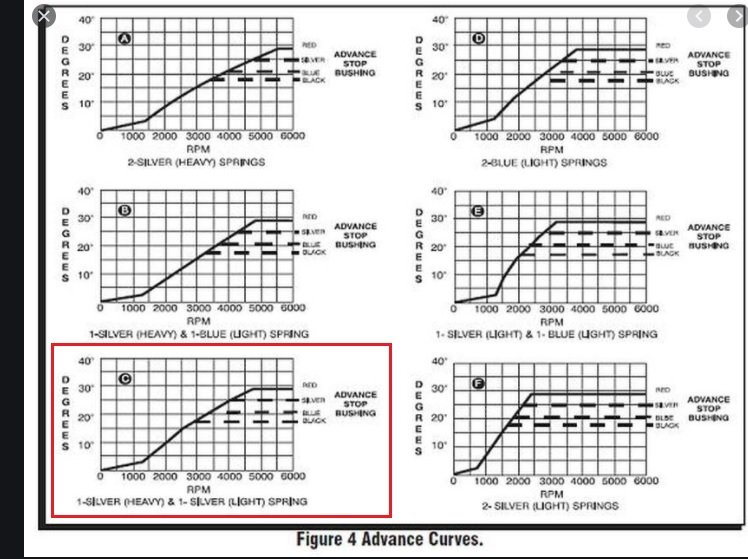

Thanks. Yes, there are only so many things it can be. As a bag-of-bolts it runs and clearly makes good power (at revs its like falling out of a window!) I just want it to not make the squirrels fall from the trees with fumes when idling.
Good news that cam might not be so wild. Nearest I have to a card is this (picture)

Good info. Thanks. I tried to get curve readings off the engine before it came out of the Daytona but vendor and I struggled to get reliable readings off it. The answer could well have been in there. C'est la vie.
From memory I am running profile3 now with black bushing. (This gives 18 degrees total mech advance at 3,000rpm).
This allows me to set ~16 initial at startup with 34 all in at 3K.
I have an adjustable vac can, but its disconnected. No point. No vacuum.
There are 3 options to bring this advance in sooner looking at the chart. Some of these will bring in a few degrees at idle sort of speeds.
Can be 34deg all in by 2500, 2000 and 1750 by the looks of it.

Re: SMELLY - De-camming for de-smelling ?
I would want one that looked like the face of the Eiger.
The only reason you have initial timing is so you can crank the motor without ripping the teeth off the ring gear.
In my opinion, you want to get as much timing in as early as possible without causing drag on the convertor - this is where the trade off takes place.
Don't underestimate the Vacuum canisters - they have their uses, but ironically not how they were intended....

Yes. Thought about that (locked, programmable) which can work really nicely with sniper injection too.
Which of course brings me back round to my question in the first place - "Am I wasting my time trying to make this cam not smelly". To which is seems the answer is 'No. Plenty run specs like that without the stink'. Therefore its worth me pursuing a better fuelling/timing solution and not worrying so much about the metal bits.
