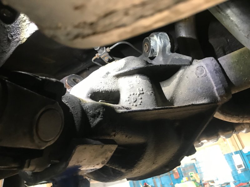

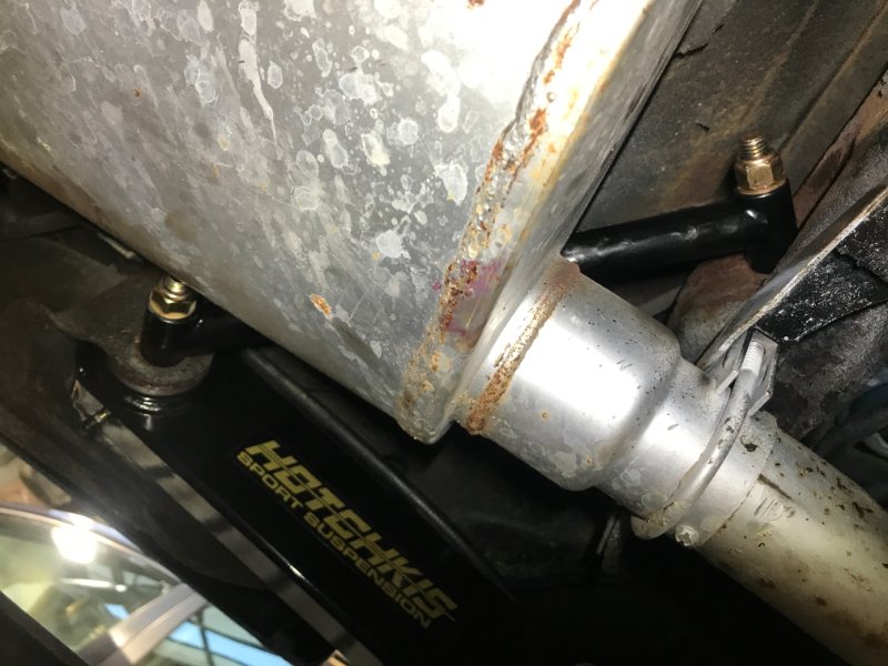

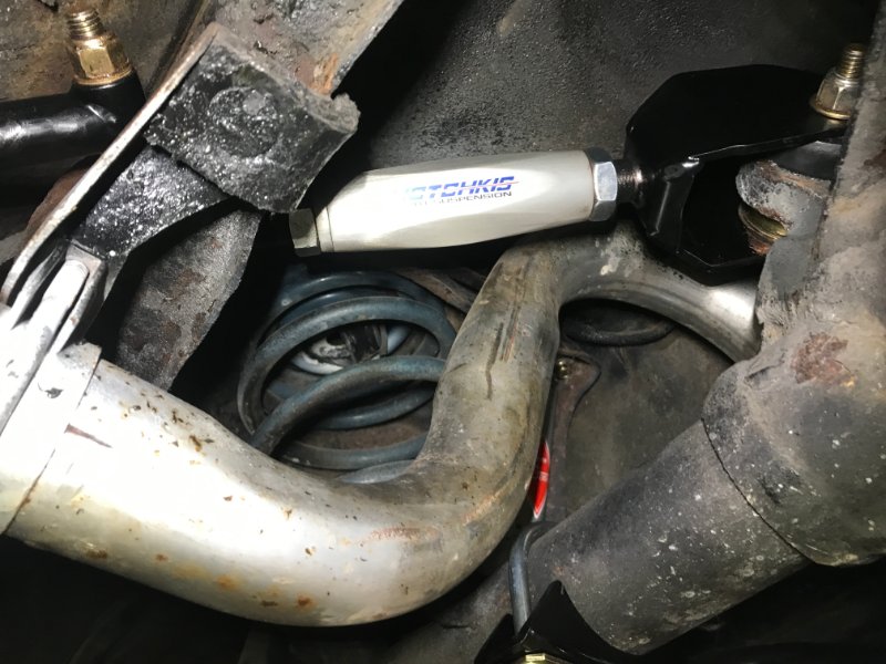

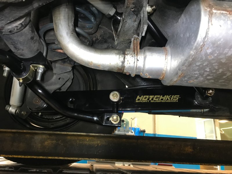

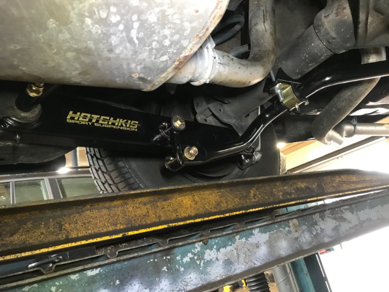

Just fitted Hotchkis front/rear sway bars and rear trailing arms kit with upper diff mount poybushes, all bushe's are poly, car used to roll to much on corners for my liking, typical midsize yank although ride was superb, had already fitted kyb gas adjust rear shocks and stock fronts. kits are excellent quality and fitment car now rides flatter and planted with hardly any roll and no understeer, ride quality is not compromised at all in fact feels better, well pleased and although just a cruiser well worth the investment as not cheap. Rear upper bars being adjustable means you can set diff rake and balance axle load balance,
Have just got a hotchkis rear sway kit for the satellite, so fitting that shortly, hopfully will stop the rear corners rolling about
