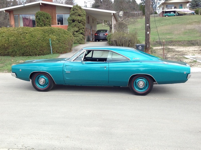

Re: Painting the Charger. Advice needed!
This ?
dark turquoise metallic
Yes that's it!

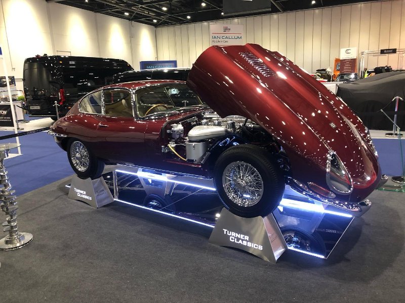

download/file.php?mode=view&id=134513
Cool, this is one of mine, all painted in bits! , not as scary as some would have you believe
Im out of this type of stuff now, much prefer my cars and my feet on the ground!
Enjoy ................
