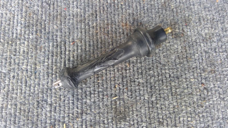

Please, does anyone recognise this part and possibly tell me where to buy.
It is on a Stage .v head using Taylor connectors.
Thanks.
Sorry about the pic size, I am old!
Thanks.

Re: Hemi HT Help.
its a converter from Bullet style/ HEI style connector, to normal plug connector but its complicated by the fact that on your hemi it needs to go down a long hole to get to the plug and potentially seal against the valve cover
these might work
https://www.demon-tweeks.com/magnecor-8 ... ViEALw_wcB
you'd need 2 sets
but can't say if the length of lead or the length of that through cover adaptor is going to be correct
but looks like you can get the taylor bits here
https://www.taylorvertex.com/spark-plug ... ire-parts/
Just got to find a UK agent or ask WASP
or get RON at STS to bring them in, in a container takes a month or 2

Re: Hemi HT Help.
Hi Dave, and thanks for the reply.
I see where you are coming from with the magnecor idea but cannot see that sealing against the top of the rocker cover, two sets would work but would need to cut the ends off my Taylor leads, there is nothing wrong with these so seems a shame.
As for the link to Taylor, I spoke to their tech last week and on his advice ordered the 44000 set of tubes. That was £90 with the tax wasted as they are nothing like, they are just the empty tubes for $60 no seals clips nothing.

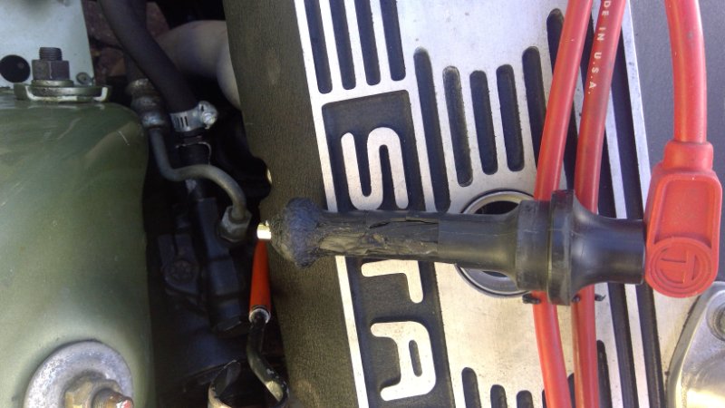

As you can see from the pic these are dropping to bits and so fragile that i am reluctant to mess with them. I don't believe these are unique.
Thanks for your input. Spike.
Re: Hemi HT Help.
well i tell you what
this might work
look up ford EDIS or FORD Zetec ignition leads on ebay
big tube rubbery seal and fit the bucket connection on a standard dizzy cap
this kinda thing
https://www.ebay.co.uk/itm/Ford-C-Max-I ... Sw0QlgGcXJ
if they don't fit back on ebay the next day
this might work
this kinda thing

Re: Hemi HT Help.
Dave.
They all look good particularly the zetec ones as these would seal against the valve cover. The NGK caps are no go, we have some of these in stock at the shop and they sit so low that it is difficult to remove without longnose.
I also thought about using a rubber end from a donor like the Zetec and attaching it to what i have using adhesive lined heat shrink. I figire all i have to do is make the path of the spark longer to stop it arcing out in the tube. I did not think there was much of a problem until last night as it was getting dark you could see the odd flash from the plug tubes, not good but with a few RPM goes away, this would explain a lumpy tick over!
The other thing i have noticed is damp in the spark plug tubes, this does flash off but again will add to my problem, the tubes are not oily. A possible answer is the car being sat over winter, also it got wet through when i went to fetch the car recently. I am going to get everything dried out properly and try again.
Of course if you or anyone thinks of another answer please let me know, New leads are an option but a shame to throw away a perfectly good set of Taylor leads.
Spike.
P.S. Am I allowed to fit Ford parts?
Spike.
