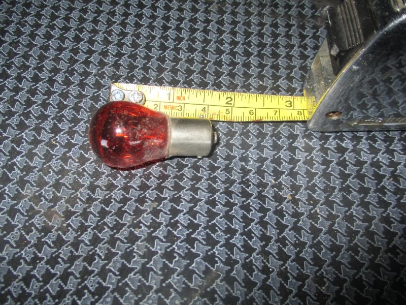

Posts: 1165
Re: amber light bulbs
This is it with double contacts. Looks like it will be a paint job. Used to have no problems getting these locally but times change. :thumbright:

Post by mustangbooks »
That one has a single contact... I presume you mean that it's the kind of bulb you want, but it should have double contacts instead?
Posts: 1165
Thanks, that's the rear indicator. I was sure it was double contact. Never do a job when drink has been taken. In which case i am fine :oops:

Posts: 1165
Got these for the front. Double filament and dual contact offset pins. The single contacts are fine for the rears. Glass is a bit smaller but holder looks the same. Will try them today. Not as orange as wha is t there but should be ok. :thumbright: Took a while to be delivered.Cheers guys as always.
