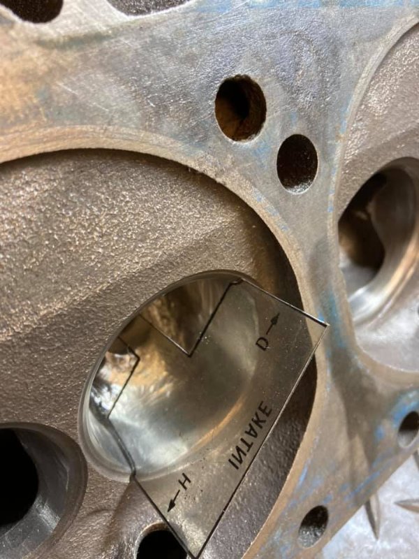

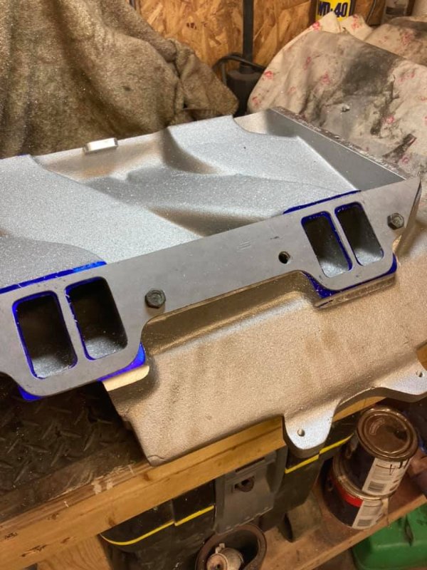

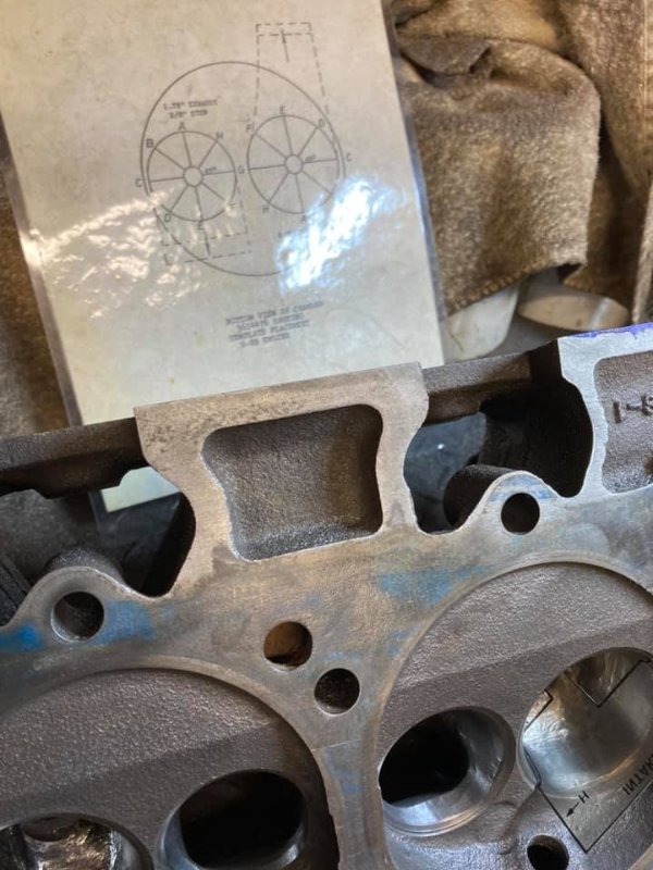

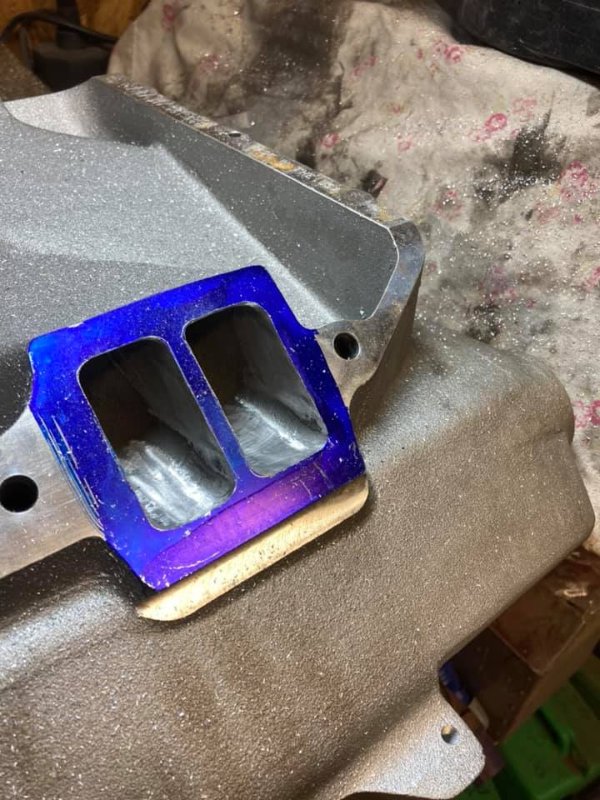

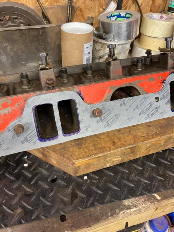

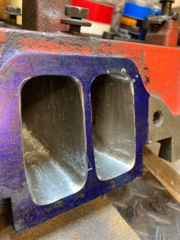

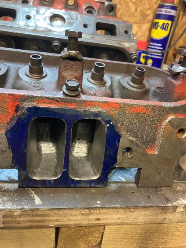

few hours work and they are ready for the machine shop .....thanks to Blue for the porting templates ..Will they work ???who knows .....i am going to try and measure the inlet runners for the volume to see if they are all even .....new valves coming this week then of for a valve job ...pictures in no particular order

Yes they will work, you have taken out the restriction under the valve basically.

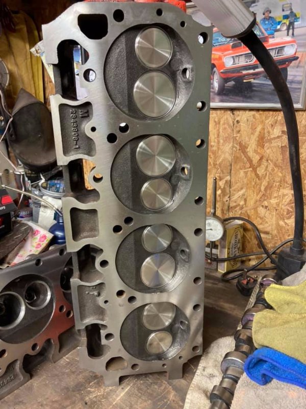

Got my heads back today from AMS ,valve seats all done ,slight clean up on the face ,porting finished up a bit better than my finish ...All said and done not as expensive as i thought and well pleased with the result ....will they work ???

I have ordered a set of stock replacement Molnar rods and a set of Diamond lightweight racing pistons ,not sure what the final comp ratio will be as the block is being decked and honed as we speak but it should come out somewhere around 12.1 ....Block is being honed ,decked ,1/2 inch oil pick up fitted along with studs for the main caps .So pretty basic upgrades for a stock engine .....cam is a bit up in the air at the moment as i plan on getting one ground by Hughs
