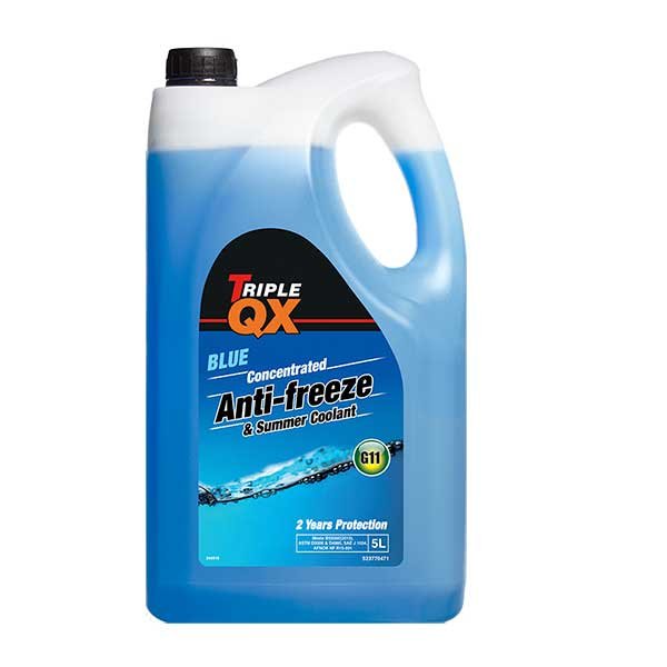

Went out for a spin yesterday. Normally I drive front in but for some reason decided to back her in. Talked to a neighbour and turned round to lock up and found a small pool of antifreeze on the floor. Saw where it was coming from so pulled the rad out last night and got it fixed locally today by a lovely man in his 80s. Thing is I can't get the green glycol antifreeze here, he also says that is so. So i got this, he says it will be fine. Just want to check with you guys first before i put the rad back in. The blue stuff. I'm sure I saw a post of someone using it before. Way too hot today to be working in a garage. Glad you all enjoyed Brooklands, those who made it. BTW I got the ready mixed type.

Not sure how the blue reacts with the older type rubber seals - to be safe I use the Prestone yellow that a lot of the cars over the pond are running Its available in Costco if you have a card and its only £12.00 for 4 lts .

As far as I know, blue and green are both glycol based, it’s the yellow and pink that’s synthetic.
