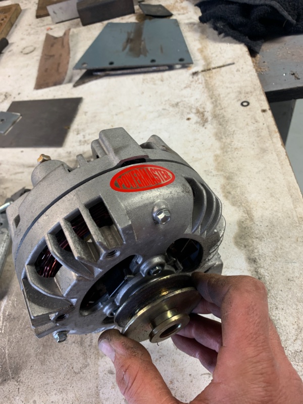

On the Naughty Step today.
Powermaster alternator.
3 years old / 2000 miles.
Making horrible squealing noise.
Aaaargh

Can you do an autopsy on it Mat please.
To see what can be done to stop failure ?
Re: Rubbish parts
Posted: Thu Jun 10, 21 9:08 am
by Matt
Yes if i can get the pulley off !
Keep you posted
Suspect a dry bearing

Just a heads up on the cheap imports.
Take it apart and grease up the rear bearing. Mine too was quite dry even from new [-X

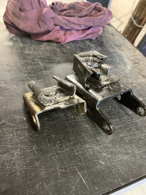

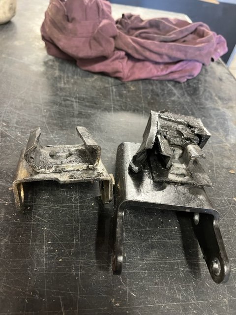

Next for your viewing pleasure.
Polyloc engine mounts . $240 USD . Probably best not to bother. The other side was worse than this one.
