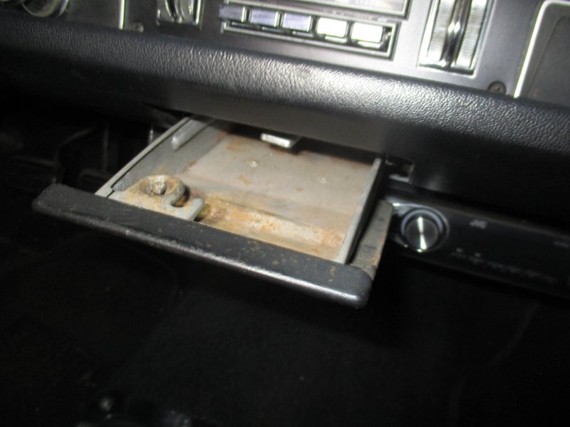

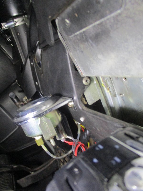

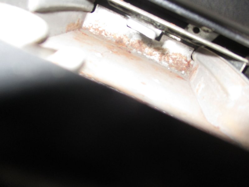

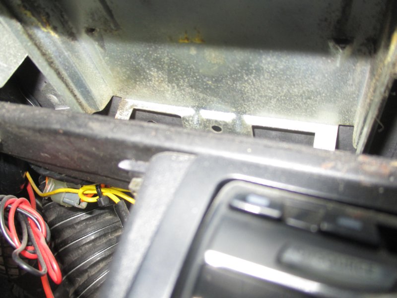

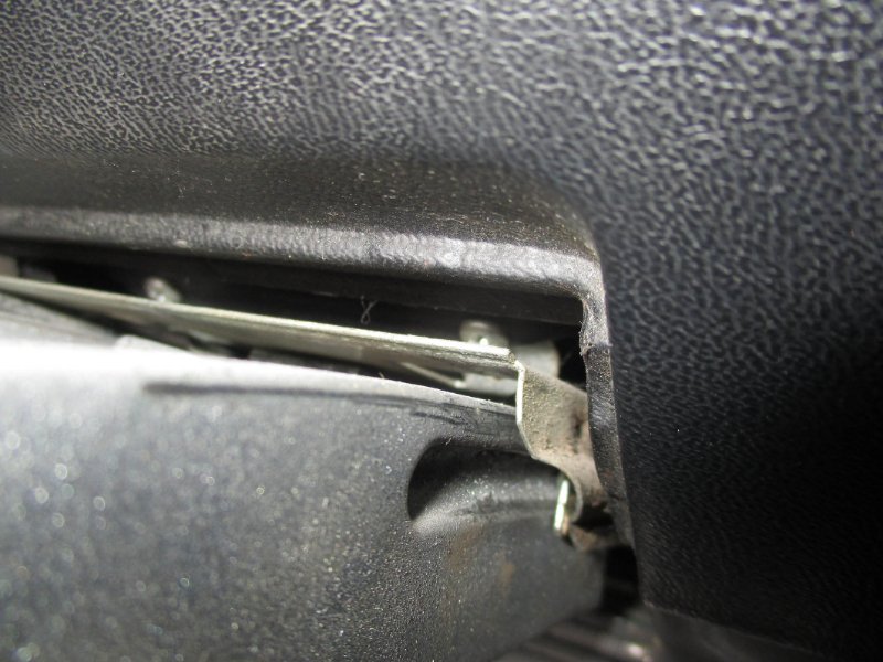

Posts: 1177
Re: I'm stupid.......A body Ash Tray
Billybob, the flat unit the ash tray slides into appears to me to hook over the lip at the back. (68 Dart).
tray 1.jpg (109.59 KiB) Viewed 10242 times
tray 2.jpg (97.52 KiB) Viewed 10242 times
tray 3.jpg (109.59 KiB) Viewed 10242 times
tray 4.jpg (95.16 KiB) Viewed 10242 times
tray 5.jpg (56.26 KiB) Viewed 10242 times
tray 6.jpg (74.41 KiB) Viewed 10242 times

Thank You now done with brute force and more stupidity !!
