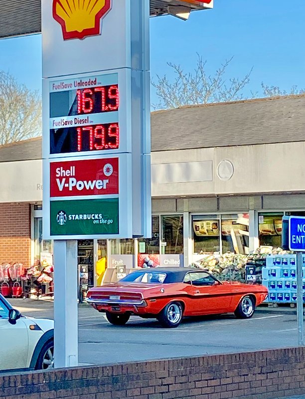

Re: E10 petrol
Filled up with E5 today at our local station, was £1.84. I know prices are high at the moment but Shell are taking the Bananarama!.
Posts: 7307
Re: E10 petrol
And the annoying thing is it's just the old normal unleaded disguised as super unleaded
Posts: 2332
Re: E10 petrol
Steve wrote: Mon Mar 07, 22 5:42 pm And the annoying thing is it's just the old normal unleaded disguised as super unleaded
Forgot about that, yes you're right, makes it even worst.

Posts: 5807
Re: E10 petrol
I thought 168.9 was bad round here for diesel.
Costco still only 149.9 :thumbright:
