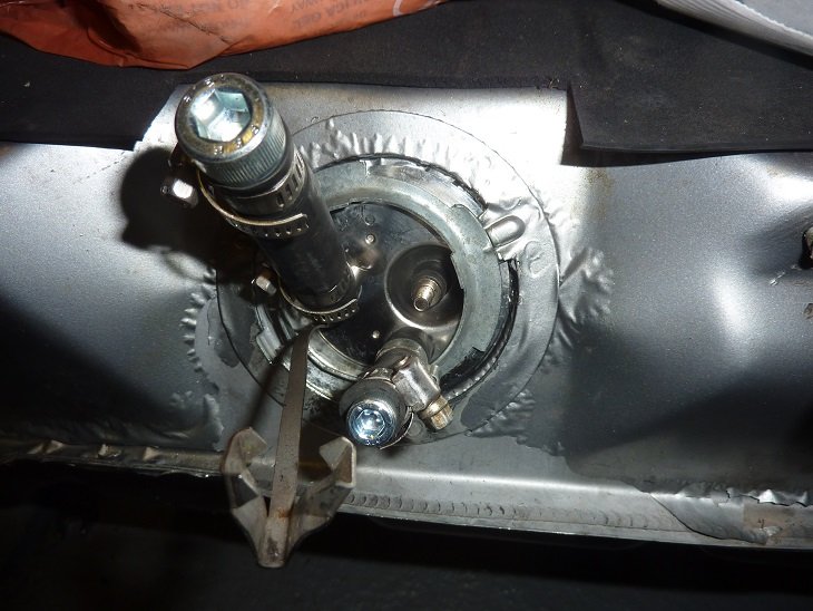

Anyway, got the sender out and it's pretty obvious why it was leaking - way off centre. And i don't think the paint around the hole helps.

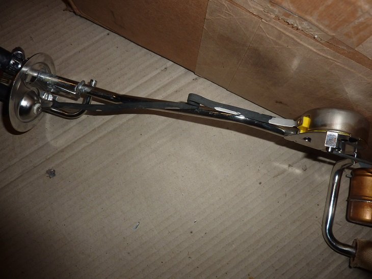

Question - on the sender there's a rubber sleeve over the metal strip, that is deteriorating as it's clearly not immune to fuel. And there's bits of it in the bottom of the tank along with flakes of paint. Is it to insulate it electrically from the body of the tank? It would be nice to get rid of this sleeve or replace with something more durable.
Even with it out, access is pretty difficult with the clamp for the return line hose being so close to the ring.

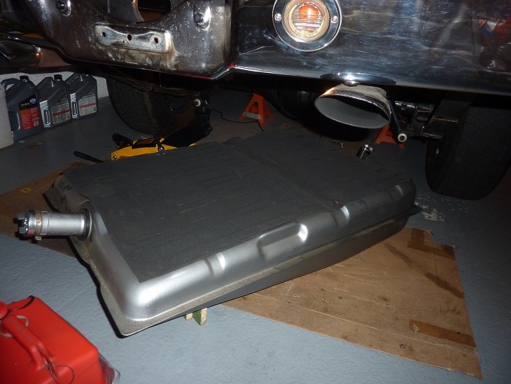

Got the tank cleaned out, a few bits of flaky paint from around the sender, and some rubber presumably from the sender arm.
Tried the thickest locking ring I had but it was too thick, so went with another of a similar thickness but the raised portions were higher so it did pull in tighter. Used the tool to tighten but even that will work itself off-centre so need to do it bit by bit and keep moving the tool around. Not sure that there would be room to do that with the tank in situ.

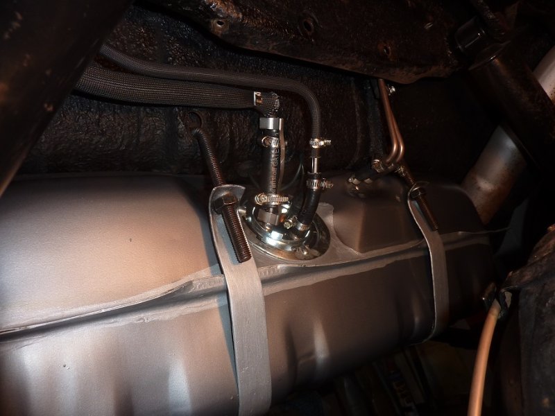

As per Adrian's suggestion I put a couple of gallons in it and stood the tank on end. No apparent leaks so touched up the areas where the paint had been come off with some silver Hammerite.
Rob helped lift the tank up in place when we got back from the HRD's.

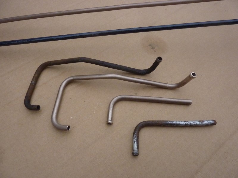

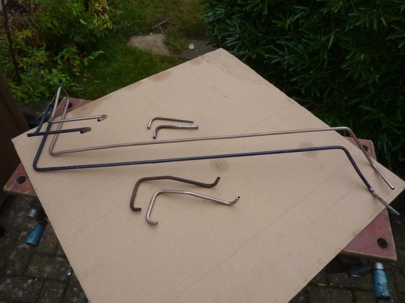

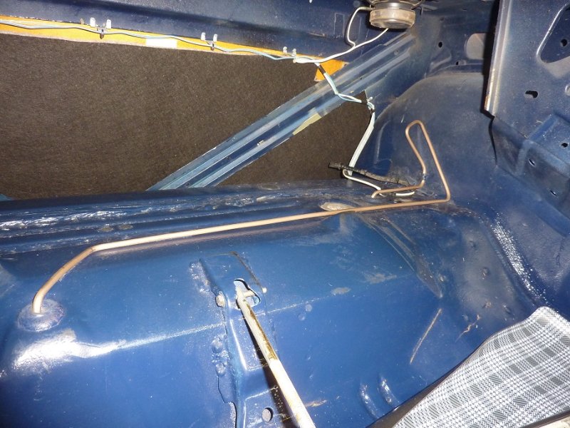

I made up some replacement vent tubes as the originals look every bit of their 52 years old. Nothing wrong with them really but didn't seem right putting the old ones back on.
All looks nice down there and in the trunk now, shame no one will ever see it. Apart from when I take it for the MOT in a few weeks.
Just need to be able to fill it up now...
... if any one could use some old vent tubes for a 69 B body (not sure about a Charger tho?) even if to use a patterns I can hold onto them. Otherwise they'll be going in the bin.
