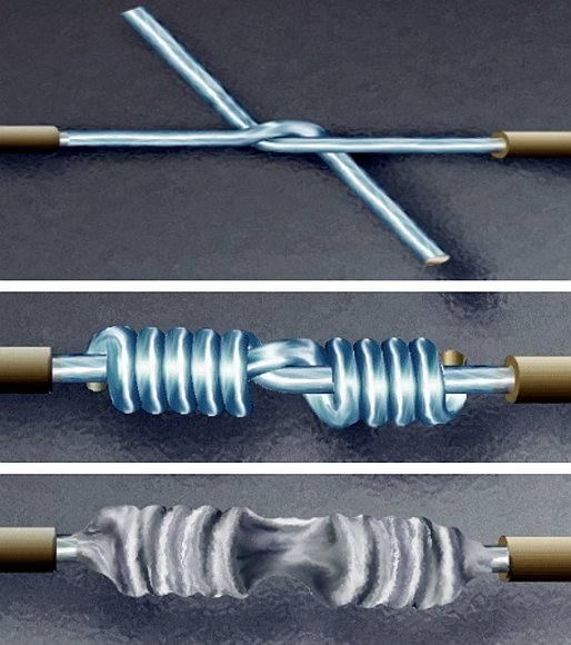

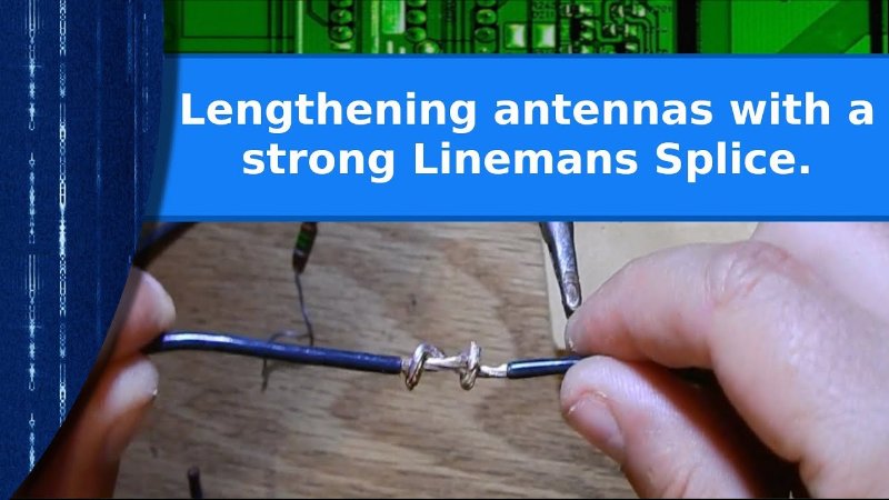

Use the linemans splice to join the wires after slipping some shrink tube over. With stranded wire you will need to twist each free end to make it more like solid core. see below you should end up with a join no fatter than the wire and insulation either side, so you can slip the heat shrink over and shrink it

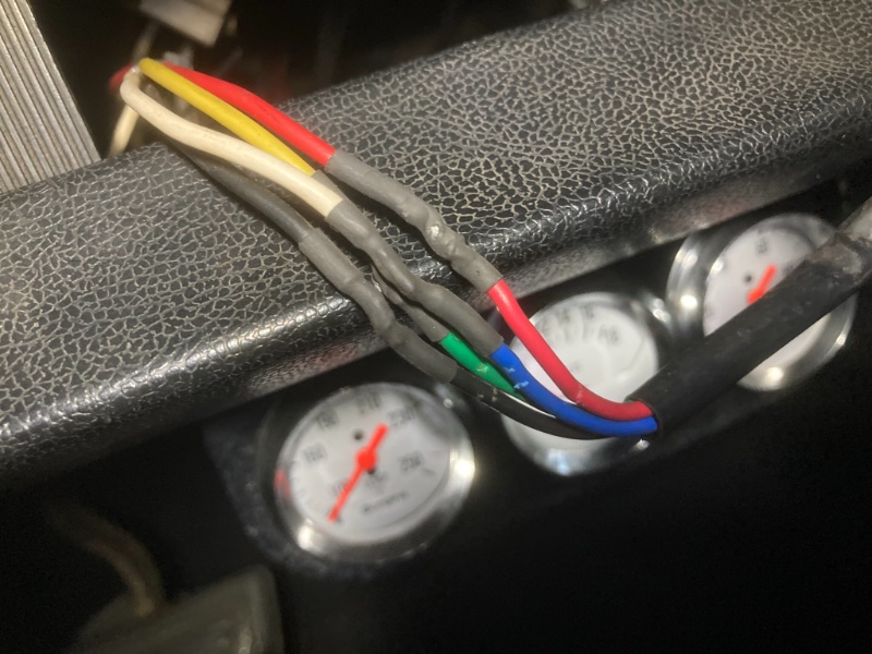

Here’s what I’ve got at the moment, I had planned to basically cut the joints, route the tach up through the dash speaker hole and rejoin the wires to the same ones they came from. [-o<
I’ve no radio or speaker and no plans to get one, I plan to mount mini gauges where the radio was, but I’ll start a workshop thread on that.

other option would be to solder and shrink wrap after cutting wires.... soldering iron, heat shrink and linemans splice necessray

that picture you have is a perfect wireing diagram so you can connect the coloured wires the correct way.... store it off in a folder somehwre called wireing my car

Dave999 wrote: Tue Oct 05, 21 1:57 pm that picture you have is a perfect wireing diagram so you can connect the coloured wires the correct way.... store it off in a folder somehwre called wireing my car
Yep, I figured it was the easiest way. Snip, reroute, reconnect to same colours (note to self, try and remember 20 years ago soldering lessons) and cross fingers it still works. :D
