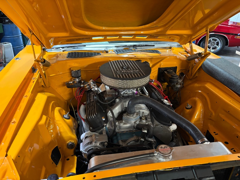

Solved the majority of big issues over time that caused it to be laid up often unused for so many years, stuck a new shifter in, ally rad, new water pump, clutched fan, arsed about getting trans leaks fixed and stopped some bits falling off.

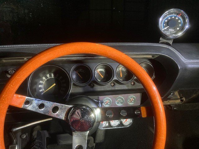

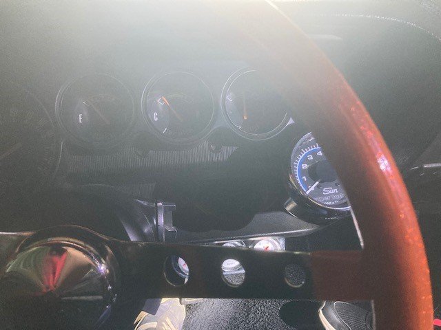

Latest thing that's doing my head in and has been for some time, is the fact that I can't see any of the aftermarket gauges when driving. All of them really badly positioned, nightmare when driving and bloody dangerous when you have to keep your eye on them all the time, which was the case when I had all the overheating problems. Here's the view of the gauges and tach as they came from the former owner about 10 years ago. You can just about see the 3 additional gauges hidden behind the steering wheel spoke and the tach is half obscured by the rim.

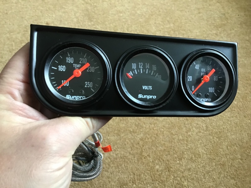

I've long wondered if I could use the radio aperture to fit the gauges, as I'm a big fan of neat and tidy and easy to use, so I decided to measure up and move the tach to see how it would look. Made a cardboard template and printed some mini gauges and I like the way they fit, so have ordered some mini 1.5" gauges and will fabricate a plate shortly.
I quite like the idea of having the tach on the dash, but am a bit worried about sticking a hole in it... Mind, as a wise man said to me at the racing, what better place for a tach than straight in your line of vision. :D
Thinking I can probably route the cable up through the speaker grille. Might get a few shaken heads at cutting the grille, but it's been snapped and badly glued back together already and I'm not going to use the radio again, so I figure why not...
Mocked up tonight and happy with the mini gauges, still thinking about the tach position. :-k

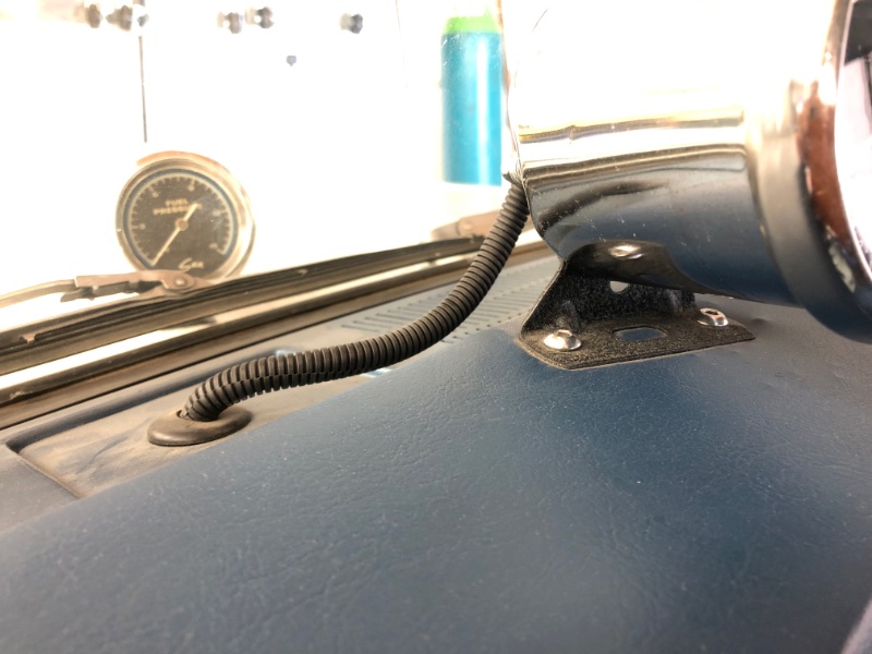

I put the Tach on the Steering Column on my "E" Body, easy job, line of sight. Not perfect but a good compromise.
Mine has a Rallye Dash so not masking key gauges as your might be...
If the Dash is perfect and undamaged I would NOT be making any holes in it....

I'd considered steering column, but no crush can so space is tight and visibility of the other gauges isn't as good there, so not so keen.
I agree if it was mint, then I'd feel pretty rough about sticking a hole in the dash, but the pad is cracked anyway, so I'm not feeling too bad about it. I don't envisage ever letting the car go, so figure If I'm happy and it suits what I need, then I'm feeling pretty relaxed about that.

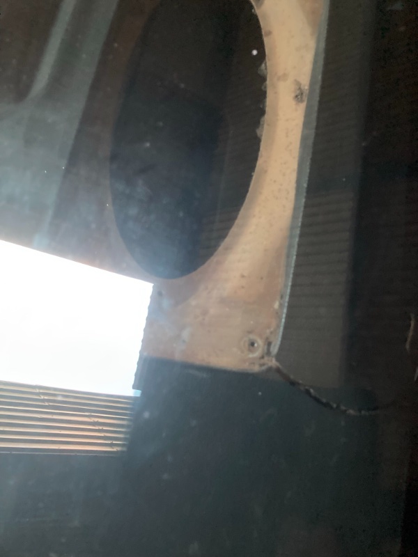

Can you make a Plate up that covers the Speaker hole and mount the Tach on that?
Posts: 7202
Cheers Mark
Pete wrote: Thu Oct 07, 21 10:15 am Can you make a Plate up that covers the Speaker hole and mount the Tach on that?
Now that is an idea with great merit that I hadn’t considered… :-k :thumbright:

Mini gauges just arrived, which was a nice surprise. Can get busy getting them out of their bracket and mocking up for the one to fit them into the radio aperture now. 8-)

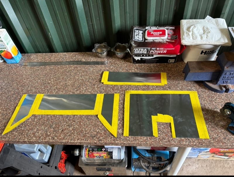

I’d definitely make a thin ally cover for the speaker and wrinkle Bananarama! for no glare. I tend to use Tiger seal to glue on stuff like that which is what I did to block off these vents.
