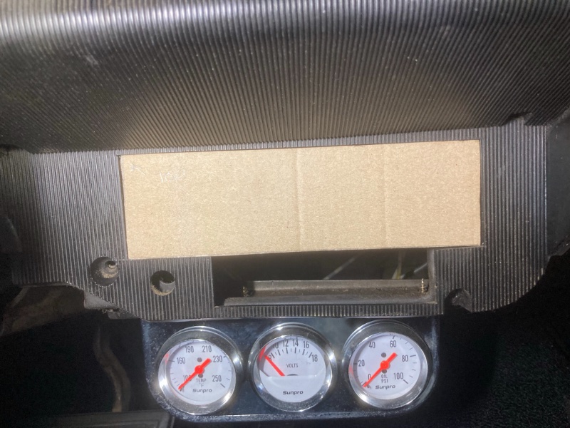

Stu wrote: Thu Oct 07, 21 3:05 pm Mini gauges just arrived, which was a nice surprise. Can get busy getting them out of their bracket and mocking up for the one to fit them into the radio aperture now. 8-)
I'll be watching this element closely - Faux doesn't have a radio and I like the idea of putting mini gauges there instead. Hope it all works well!
Posts: 6898
Me too, I did toy with the idea of using the ones I had, but they would have been really tight and I don’t want it all to look squeezed in there. Plus I wanted black faced gauges instead of the white ones.
They are discontinued unless you want Bosch written on them, so had to find a NOS set on flea bay, but other than faded packaging they look ok. I’m hoping they will plug and play with the existing wiring etc as they are the same make, just smaller. Maybe that’s wishful thinking. :-k :D

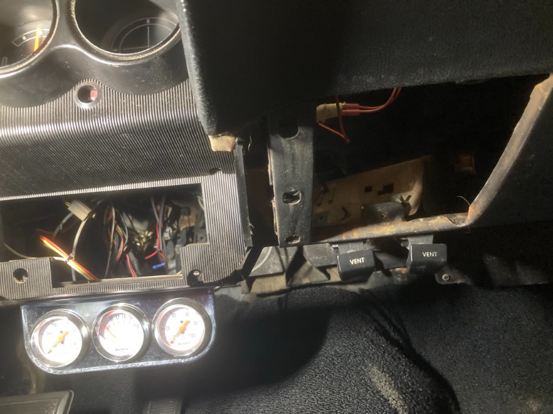

Didn’t realise I’d have to take half the dash apart to get the last panel out, but when I got it out, I had to spend a while getting what looked like 50 years of Bananarama! cleaned off everything. Got it cleaned up and am glad I’ve invested some energy in getting to grips with wiring solutions, as its all held together with a million bullet connectors and tape behind the dash… :cry:

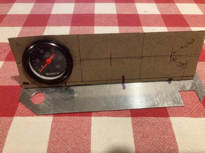

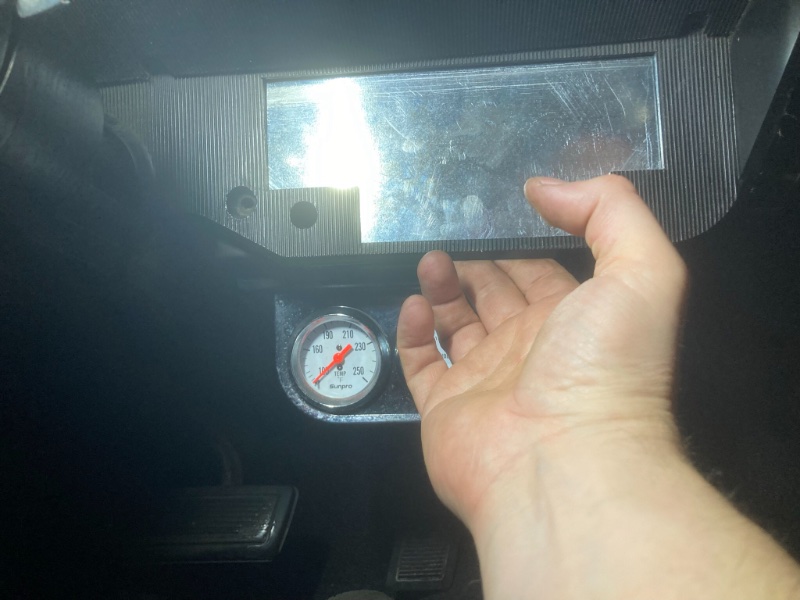

Decided to start on the radio plate cover and gave up on the ali sheet quite quickly as it was just misshaping too easily, so turned to steel sheet instead. Spent a while mocking up and trying to get a plate to sit flush with the panel it was going into, with the intention of making another plate to go behind that, but quickly realised that wasn’t going to work, so abandoned plan and got to making a plate that would go behind the whole lot and bolt in via the existing holes.
Posts: 6898
Now that I’ve got the basic shape, I was busy mocking for the gauge holes and realised two things.
1. I don’t have a 41mm hole saw or step drill, everything but… :roll:
2. I’d become obsessed with feeding the plate up from underneath, trapping it between the dash frame and outer panel, knowing that the gauges would be fed in from the front, suddenly realised that I will still have to tighten them from behind, so no idea how I’m going to achieve that, other that growing some extra arm joints and lying upside down in the footwell, so that is a new challenge to figure out.
In the meantime, ordered a click and collect 40mm hole saw for the morning and taking the grinding bits in the hopes I can manage something tomorrow.

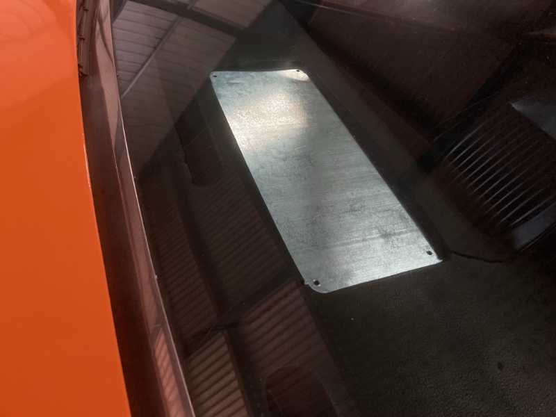

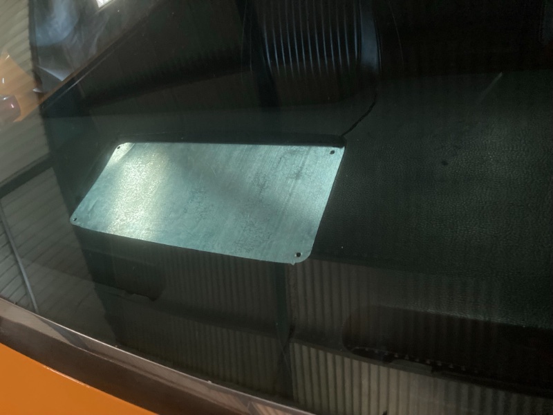

Drawn to a halt without the right size ‘oles, I moved to the speaker cover plate and got busy with a jigsaw, as it’s all I’ve got.
Reasonably happy with the outline shape, just need to figure out the curve and how to get it sat at the right height.
I’m hoping that some spacers on the corners to the same height as each corner of the original will draw the curve naturally, but we’ll see.

Still pondering on the tach, as there isn’t quite enough clearance to mount it on the plate I’ve made, it transpires. Not unless I want it knocking on the windscreen. Wondering at this point if I can somehow feed the base of the bracket under the dash pad down the edge of the the speaker plate and bolt it from underneath. :-k
More offering up and pondering tomorrow…
Posts: 14193
If you get the speaker plate flush, is it possible to use a piece of thicker ally plate say 3'' wide, picking up on 2 of the screw holes and extending forward to where the crack in the dash is to mount the tach away from the screen?

Wondering at the moment if I can mount the existing bracket from underneath the dash at the front of the speaker hole. Going to try it and see.
Also just considering buying a universal cup / mount for the tack and having done with it, though it wasn't what I'd wanted in the first instance. I've noticed a small dent in the top of the tach housing now, though, so might just do that and have done. Can't find one the right size in the UK though.
Currently mooching through the garage trying to find something to make spacers out of to get the plate fitting flush.
