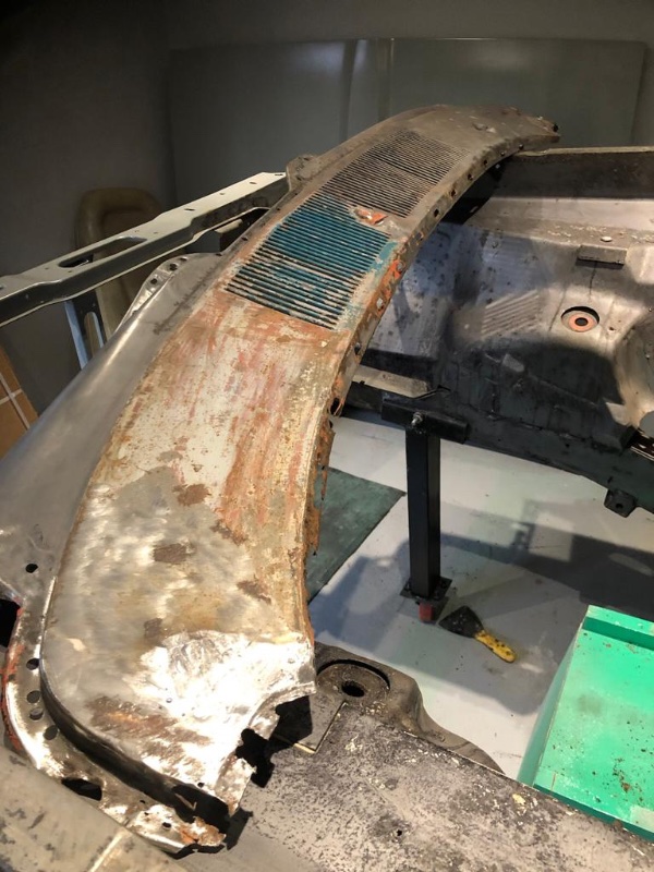

Well as I expected plenty of rust in the usual Aus charger places
As you will see they have covered the only access to the drains and the plenum areas filled up with water
Render corner beads are for rendering not something to mould grp and filler round
Also knocked a bloody great hole through the inner wing
Re: Valiant charger restoration
Posted: Wed Jan 05, 22 2:02 pm
by Minty
Removed from panel to access plenum area as I can see plenty of rust inside
Posted: Wed Jan 05, 22 2:04 pm
by Minty
Must have been filled up to the wiper’s with water at some point

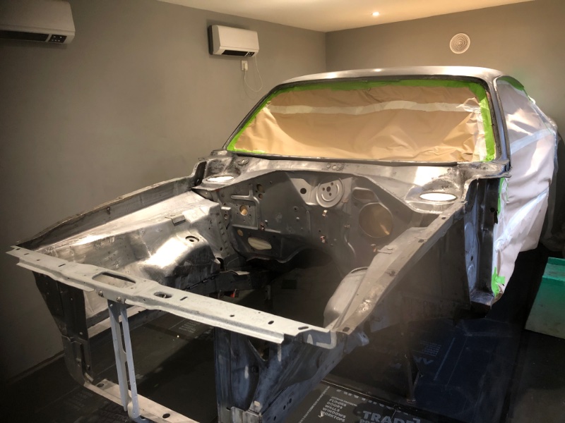

Posted: Wed Jan 05, 22 7:12 pm
by Minty
Front structural cross member was cut through as well as the lower radiator panel
Got a good straight second hand one that needed a few welding repairs

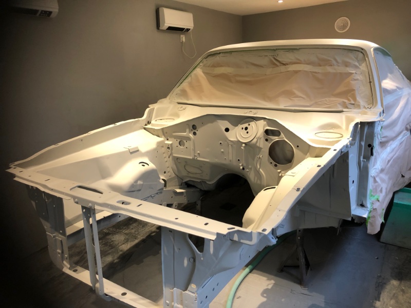

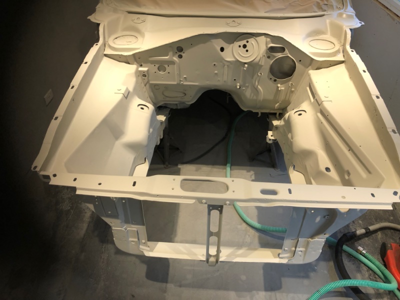

Posted: Mon Jan 17, 22 6:48 am
by Minty
Yes Dave the usual spots
Plenum area is a lot worse than minty
Front area is 90% complete
Lot’s of metal patches and plenum area has been repaired
Has had two coats of Mipa epoxy while I attack the rest of it
I thought Jack had his hands full with other projects 🙂
Door cards are shot ,the back seats are in good condition
Front seats need recovering
