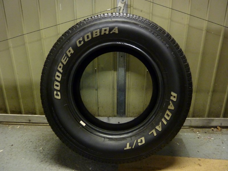

Hi Pete, I have a pair of Coopers 215/70/15. Very little use. Let me know if of any interest. I could measure the o/a height.Pete wrote: Wed Feb 23, 22 7:51 pm Brilliant, thanks Martin.
Looking at availability, I might knock it back to 215 x 70 x 15, so it gives a balanced look in terms of height with the rears.
Thanks again!

Wow! That may fit the bill if they have not gone hard.Stu Twin wrote: Thu Feb 24, 22 1:30 pmHi Pete, I have a pair of Coopers 215/70/15. Very little use. Let me know if of any interest. I could measure the o/a height.Pete wrote: Wed Feb 23, 22 7:51 pm Brilliant, thanks Martin.
Thanks again!
Please can you PM me a price please and if possible the date code on them, thanks!!!
Cheers!!
Re: Front Tyres on an "E" Body - How wide and tall??
Ok Pete, I'll get see if I can get the date info this weekend. They're currently 'in the rafters' of the garage with cars underneath.
They're probably over 10 years old but only used for a couple and stored in the garage since.
If you're not comfortable with old tyres i'd understand. Maybe better suited to burnouts.
