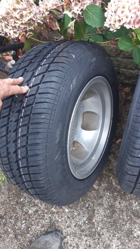

Got some new tyres on today, found some marks on the back of the slot mags saying size (15 × 8.5) "wheel dist inc" and "Ontario Cal" so nothing special I'd imagine there were loads of people making wheels back then
Rather than stainless strips in the bed I've used the original repaired one section and am painting them hammerite blue in a nod to the original finish as Dodge would have painted everything inc wood body colour
Posts: 14561
Re: 1976 Dodge D100 (Californian)
By the shape of the slots I’d say those are Shelby Cal 500 wheels, probably my favourite slot mag style.
