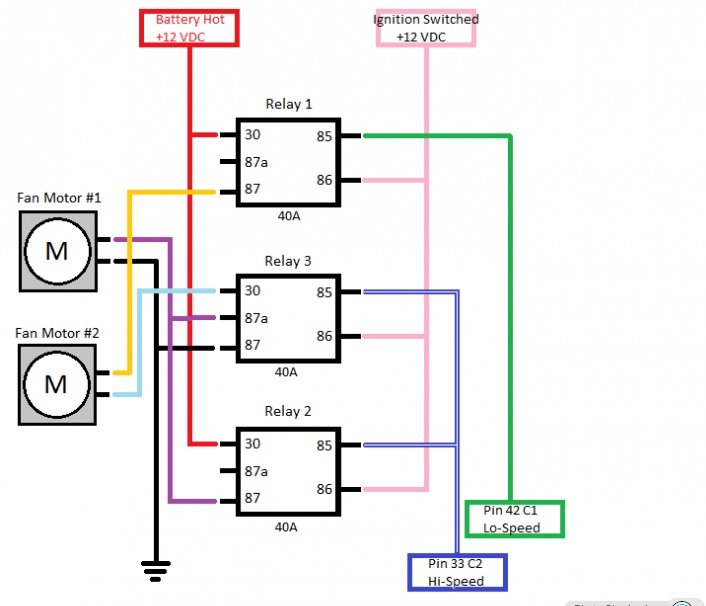

"I notice your fan is a long way from the rad core "
Just to add I have two 7.5in spall fans on the outside of the radiator hooked up to a high low speed switch.
fan wiring.jpg (46.59 KiB) Viewed 1844 times
