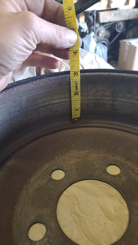

3 inch drums!? I guess these must have been upgraded as the fronts are disc, which I think were not standard either.
Re: Front suspension kit - VF
Posted: Mon Oct 31, 22 11:35 am
by Dave999
yeah look at the swept patch on the drum they take the 2 inch shoes
you have a bit of space in that drum to fit in th axle flange and fill the gap all the way to the back plate....
