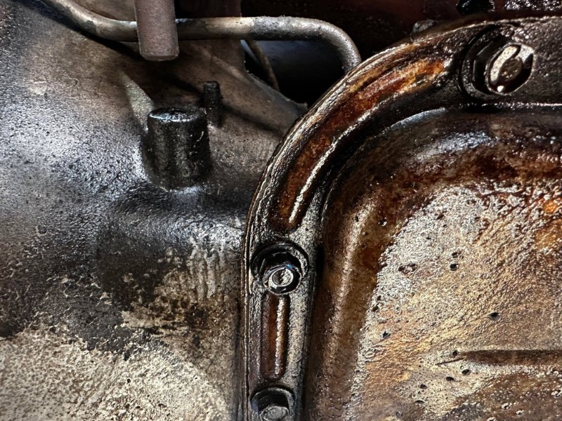

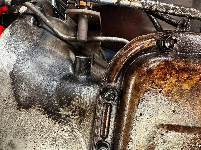

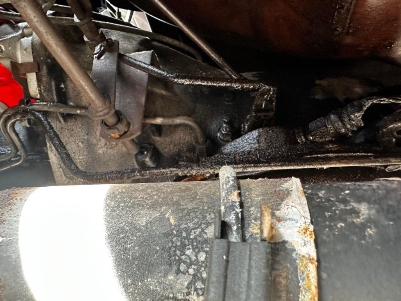

So I managed to find the time to have a quick look at why the Trucks not shifting into 3rd. Its an intermittent issue. Last night I drove into town and although it shifted into 3rd it was a little hard. On the way home it would not shift into 3rd, which was very frustrating, I gave the column shift a wee wiggle and it popped right into 3rd (I was going about 35-40mph) and it continued to drop into 3rd.
This morning I had a look under the Truck and right away noticed what looked like a bolt missing in the linkage. There's clearly a threaded hole in the mounting boss but feeling round to the end of the linkage rod and without seeing it it felt smooth, like there was noting meant to attach to it. I also noticed that the rods supporting grommet was out of position and some kind of retaining clip is missing. Anyone have one or know where I could get one?

Re: 727 hard shifting.
Hi Andy is that shaft the horizontal pivot shaft for the kickdown?
On my B body there is a stub shaft and pivoting bracket that screws into the trans casing.
Either way that plastic bush needs to be in the hole in the bracket to centralise the shaft.
Otherwise it's all a bit vague.
Edit - the last photo shows the bush in the bracket, whereas the 2nd pic it looks like it's come out?
Stu Twin wrote: Mon Oct 24, 22 1:22 pm
Doesn't look like its sitting in there to me.
Thanks for the reply.Stu Twin wrote: Mon Oct 24, 22 1:22 pm Hi Andy is that shaft the horizontal pivot shaft for the kickdown?
Yes, the bush was in the bracket and it was out.
You sound like my Wife.ScottyDave wrote: Mon Oct 24, 22 6:13 pmStu Twin wrote: Mon Oct 24, 22 1:22 pm
Is it in yet?
Jubilee clip sounds good to me. I'd have used a cable tie.
Good luck Andy.
When we retrofitted our original style shifter & console etc we had to replicate the bracket & bush that mounts to the trans for the vertical rod down from the shifter. Got a bracket made and used a bronze 'oilite' bush that works great. Press fit into bracket and will outlast plastic.
example -
https://www.bearingboys.co.uk/Metric-Fl ... gI9WfD_BwE
Not sure what size exactly. Bracket would need to be drilled out for a press fit.
Good luck Andy.
example -
