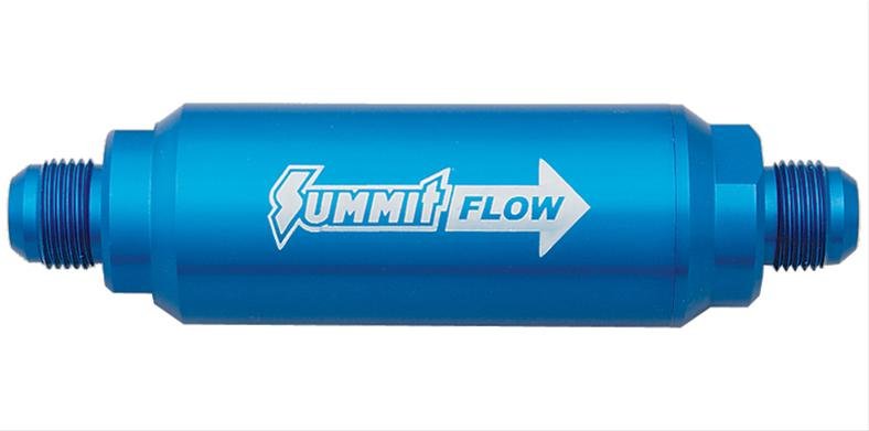

I like the ones like this . Available with paper or metal filter elements, not expensive, and fully serviceable. You could use one with -6 connections and adapt to hose barbs quite easily.
sum-230116_xl (1).jpg (22.57 KiB) Viewed 1256 times

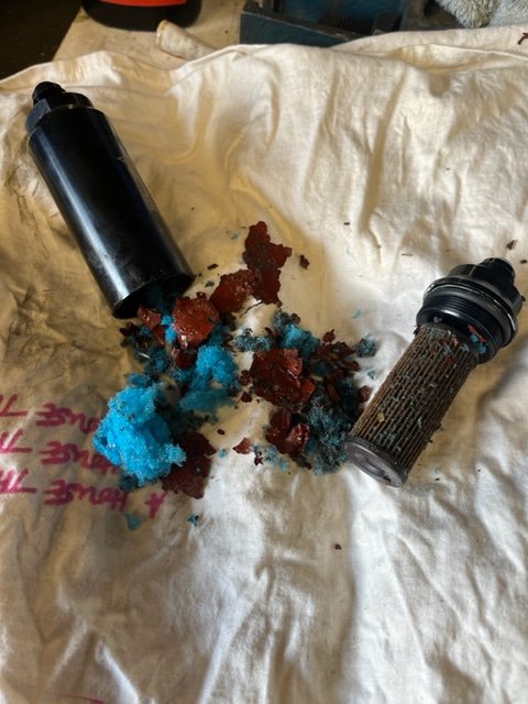

I have one in the Cuda and it caught all this without complaint. I only opened it out of curiosity . Cleaned it out and good as new.
THe blue stuff is foam from the fuel tank, the red stuff is jerrycan lining . I now have a mesh filter in my fuel funnel...
