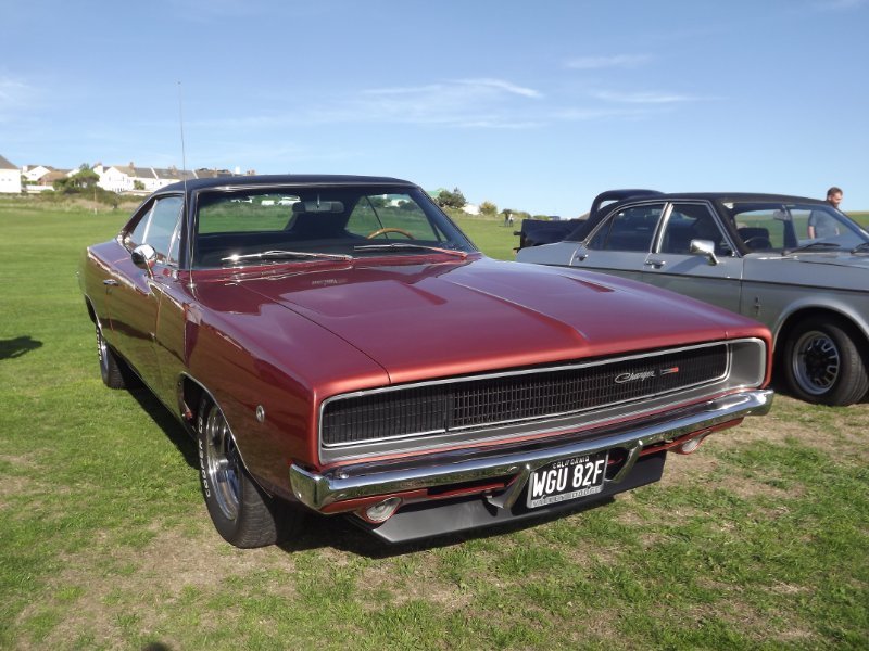

I'd send Derek a 'pm' and ask what he has on his 68 Charger.
His 15" Magnums fill the arches nicely and look to have the all-important correct offset:

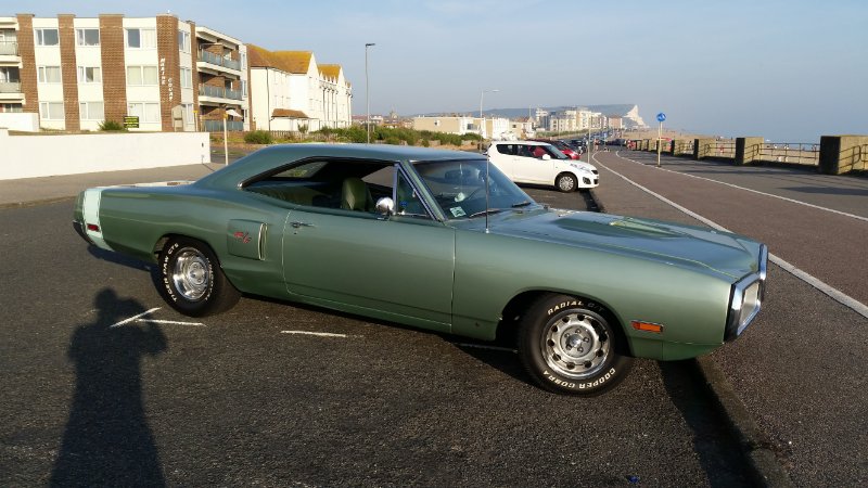

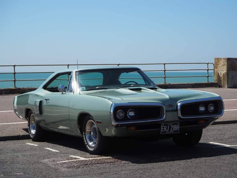

Adam have you any pictures side on Thanks Pat
Adam
Posts: 3434
Re: Wheels and tyres
Post by Adam »
Here you go Pat...
