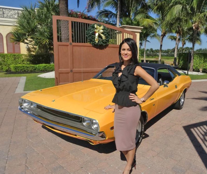

by Blue
Re: 1970 Challenger grill
Posted: Thu Feb 23, 23 9:00 pm
Argent silver lamp bezel and surround on the base models. 318 2v, 340 4v, 383 2v. Black on the R/T and T/A.
There was a base model 383 4v with argent too. 5 bhp less than the R/T.

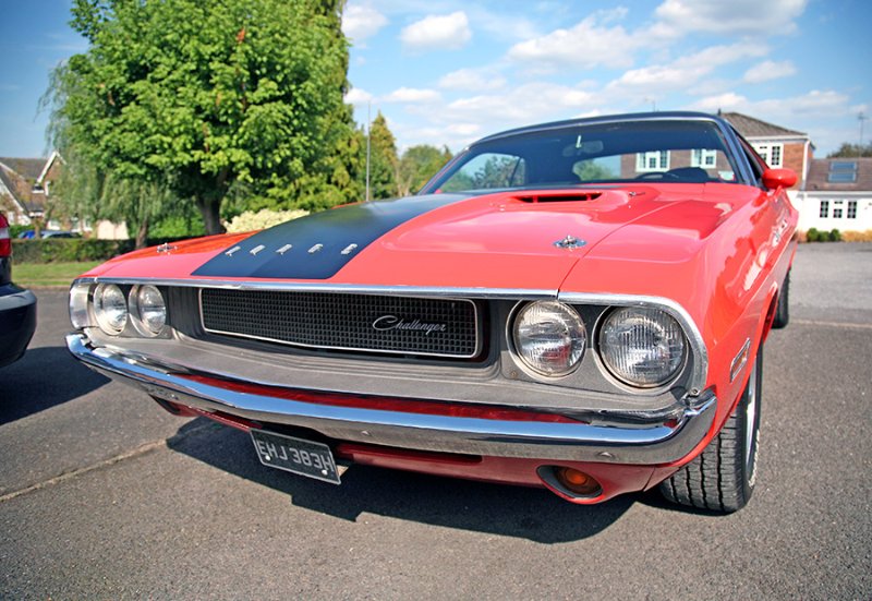

,, and to back that up, here is a Picture of my old T/A....

Cheers All.
Mark, was the bezel definitely the argent as well? I know the grille surround was, but several sources say the bezels were still black. I still think that sounds wrong, though.
Yes, agree the T/A &R/T definitely all black.

Hi Stu,
Yes the bezel was argent too. Lots of people have resprayed them black, including me.

by Blue
Looks so much better in Argent IMO, black hides all the detail.

Have you been photoshopping again, or is that someone else who’s got the oddball colour combo? :lol:
