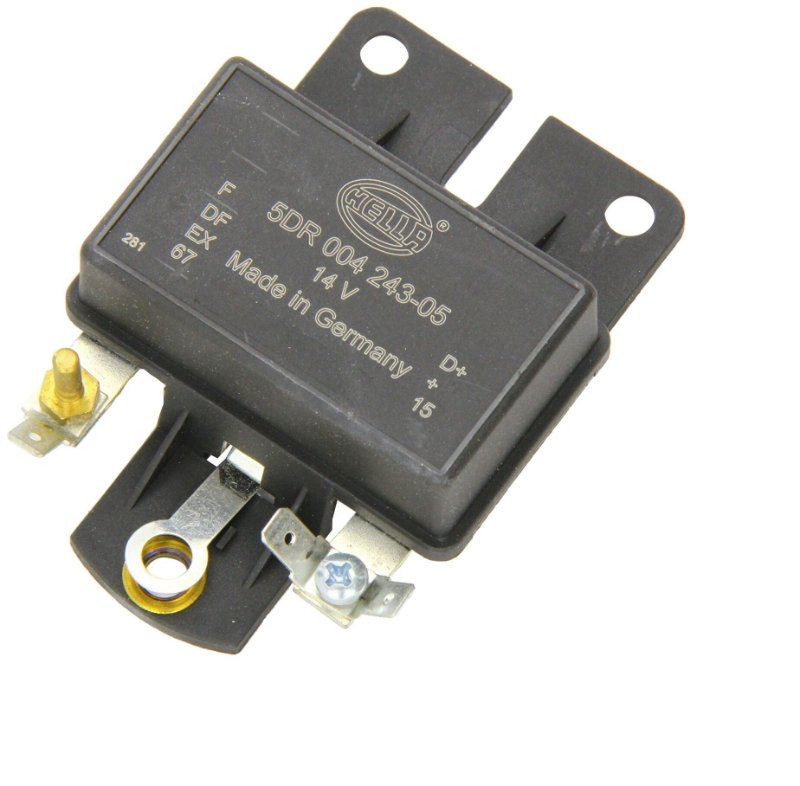

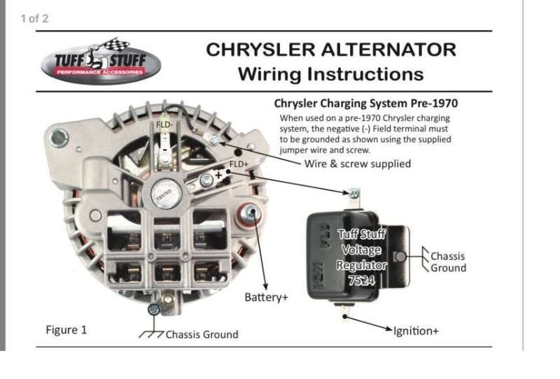

It’s a one wire alternator set up, as indicated in the picture. I use a Hella voltage regulator again pictured all was good last year.

OH ok
not a 1 wire alternator then...
it has 1 to the stud and 1 to the field
that is mostly like a standard setup from a 60s car
i.e the regulator puts out 0-5 volts depending on how flat your battery is
and it powers the field to produce the right voltage from the alternator to change the battery
what you actually have is a late 2 field wire alternator modified to work like an earlier single field wire alternator
