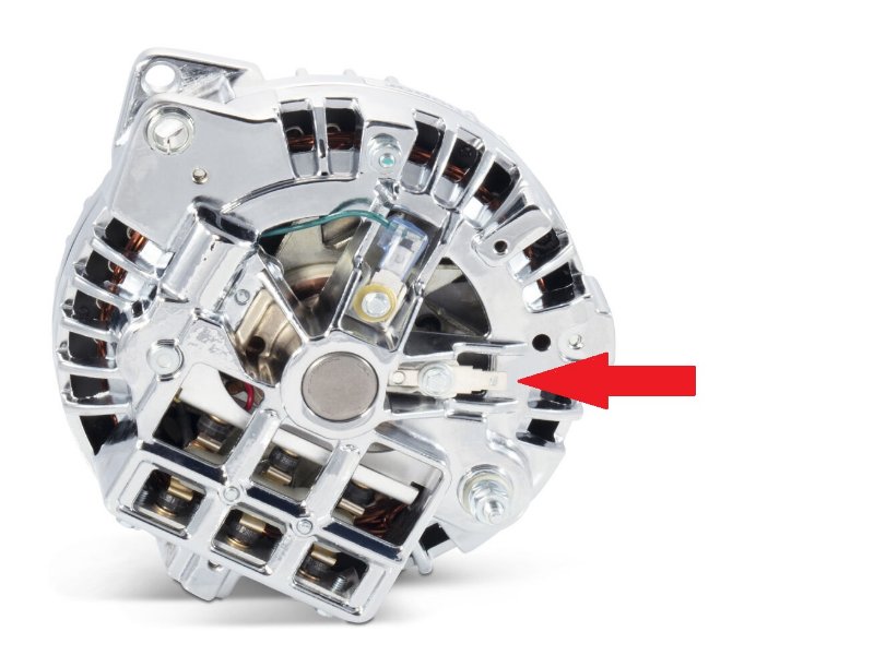

I have found the issue with the changing
As I said, I have purchased one of jeggs chrome alternators and apparently the one wire alternator from jeggs,is literally that. As it does actually only need one wire, the large one that charges the battery.
Also the jeggs alternator has an internal voltage regulator, which is why it would charge even without the positive exciter wire connected, the alternator picks up a positive signal from inside its self "GREEN WIRE" attached to one of the field spades on the back.
Now this where I went wrong, as I attached my Hella voltage regulator to the other spade highlighted.
As what they have done with these alternators is removed the little round isolating ring on the other spade connector and replaced it with a metal washer, this then earths that terminal.
Resulting in a blown Hella voltage regulator, I still can't figure out why it now won't charge on its own without anything connected . But I now have a charging system, all be it with my old alternator fitted.

Ahh so they have hidden everything in there
but left the case configuration the same as standard?
hence confusement.
the 1 wire jobby needs to see battery voltage then it can decide what to do
with no battery voltage it does nout becasue the internal regulator isn't powered up
basically the section of the circuit that was 12 volts into regulator and body/earth back to battery and the field wire are all inside the case
so if you spin it over with nothing conncetd it won't do anything.. it has no permanement magnets in it... so it won't work like a stator or dynamo.

Thanks for the help and input guys,
Nice shiny alternator now on and working with the old system inside, IE taken out the electronically controlled part
