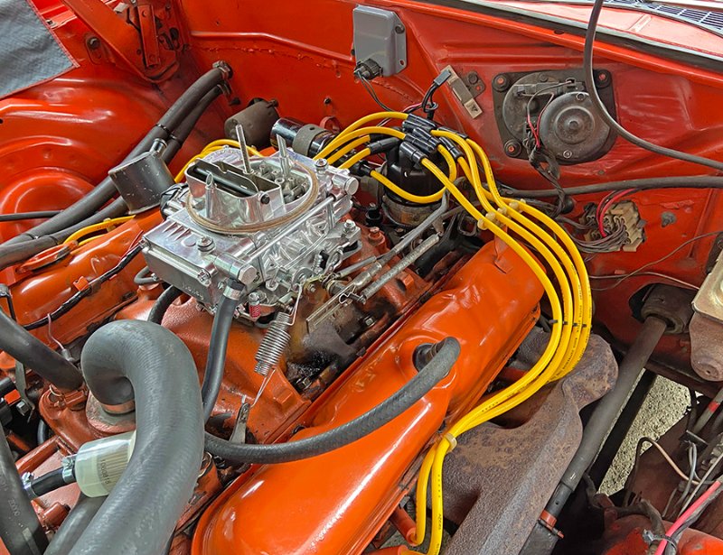

Posts: 2332
Re: Ignition cables
Went with Accel Super Stock in the end.
Posts: 21951
Re: Ignition cables
Nice job, Mark.
Posts: 14177
Re: Ignition cables
They work fine and yellow Accell leads were a 70s favourite.
