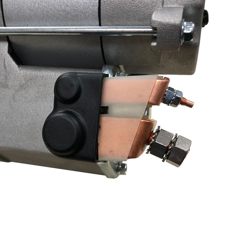

After I fitted the Mini Starter to the Dodge, I found an ad for a useful adaptor to move the terminals away from the engine block. I never did actually buy one so I'm not sure how well it works.
Just found it at Summit...
https://www.summitracing.com/parts/sum-820442
Surely worth a try at $20
(plus shipping obvs)
Re: Hi Torque Starter
Posted: Tue Aug 29, 23 7:07 pm
by Blue
That adaptor will help with the block clearance issues on big blocks but might then cause clearance issues with cables and headers, not used one either.

Minor point, and maybe not relevant at all in your case, but I fitted one to my 383 and found it much easier to fit the two cables before I offered the starter up to the block. On mine, I would say its virtually imposible (with my sausage fingers anyway) to fit the wires after the starter is in place. That and the metal plate that goes between the starter and the block made for a few swear words whilst under the car.
It took a couple of attempts to get it to fit perfectly but there is a noticeable healthy and satisfying mini ''clunk' when its seated in properly and the faces of the starter, plate and block are perfectly square.
