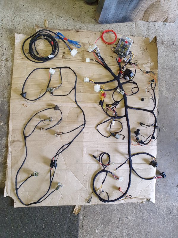

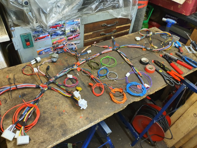

I made a complete Challenger R/T Dash loom from the bulkhead plug back when it caught fire... It was an A/C Car with lots of options, so a lot of fabrication and testing... I used the original Loom as a template.

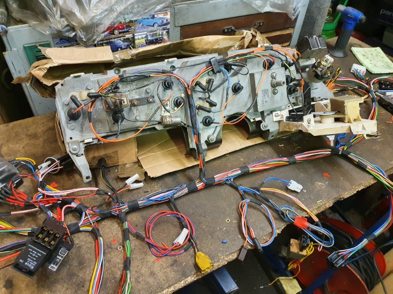

I remade my Charger's loom completely front to rear using what was left of the original and the factory diagram.
Easy enough when you break it into its sections, rear lights, A post to rear, A post & dashboard to bulkhead. Then I did the under hood wiring in situ as that was completely knackered.
Be prepared for it to take a while though, I expect even a premade loom will take some time to fit as well.

Would you say that it was worth while Pete or would you buy a ready made one in the future?Pete wrote: Sun Oct 01, 23 6:59 pm I made a complete Challenger R/T Dash loom from the bulkhead plug back when it caught fire... It was an A/C Car with lots of options, so a lot of fabrication and testing... I used the original Loom as a template.

Thanks Dave,ScottyDave wrote: Sun Oct 01, 23 7:12 pm I remade my Charger's loom completely front to rear using what was left of the original and the factory diagram.
You did an excellent job there
I didn't give the amount of space required much thought and I'd probably need to make the harness indoors.
The major issue there is that I have four dogs that will be walking all over it.
I think I need to give this idea a bit more thought!
I could go the painless wiring route but would prefer it to look factory original or close to it!

Dave has shown an excellent example o how to go about it.
I put the Challenger dash in a separate room with lots of space and even had a 12v Battery there with a test clip to prove each individual circuit off as I terminated it...Slow and Steady....

He has indeed Pete and it shows how very involved it is.Pete wrote: Sun Oct 01, 23 7:50 pm Dave has shown an excellent example o how to go about it.
I think it would be very rewarding and satisfying to make it myself but I'm beginning to realise that I'll be spending a lot of time on this!
Good tip on testing each circuit as it's terminated

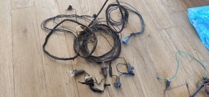

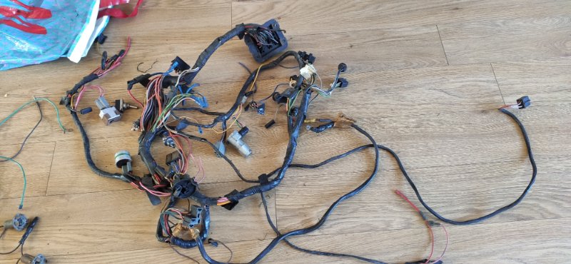

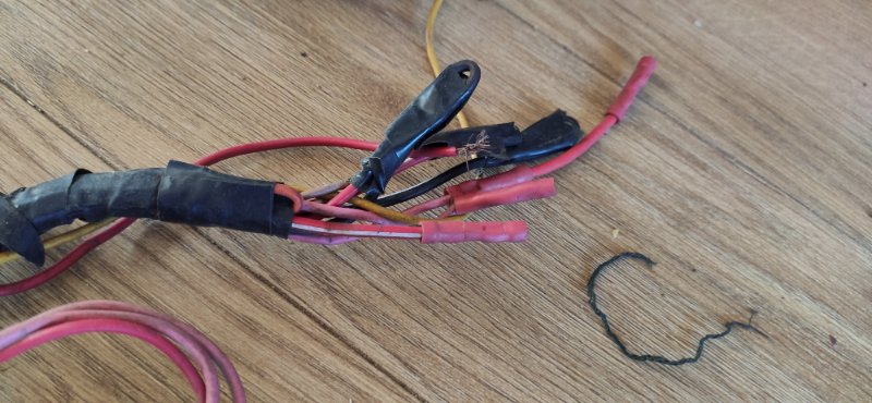

So it turns out that what I thought was from my first Charger was actually from the one I have now and consists of the dash harness and rear harness.
The harness from my first Charger could be in the loft but there's not much chance of finding that anytime soon even if it is in there. Maybe l did chuck it in the boot before the new owner picked it up. It was 16 yrs ago!
So this is what I have to with. I think I could do it but is it worth it?
- IMG_20231003_141528.jpg (95.01 KiB) Viewed 34014 times
- IMG_20231003_141537.jpg (64.45 KiB) Viewed 34014 times
- IMG_20231003_141550.jpg (68.34 KiB) Viewed 34014 times
- IMG_20231003_141555.jpg (90.17 KiB) Viewed 34014 times
- IMG_20231003_141605.jpg (77.52 KiB) Viewed 34014 times

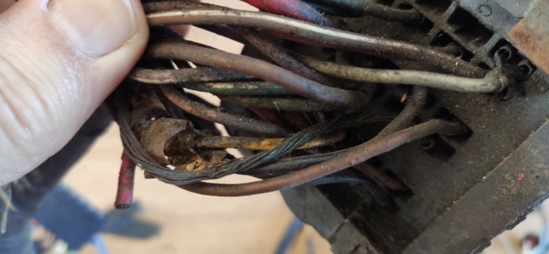

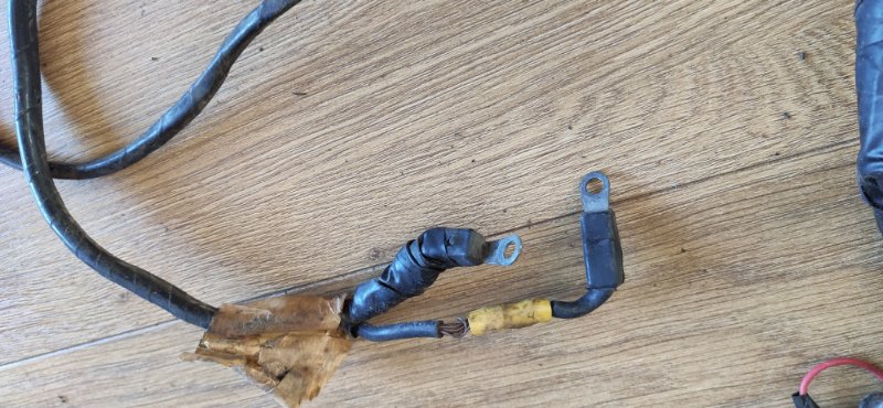

A couple more plus the rear harness.
- IMG_20231003_141616.jpg (57 KiB) Viewed 34014 times
- IMG_20231003_141625.jpg (102.81 KiB) Viewed 34014 times
- IMG_20231003_141705.jpg (89.56 KiB) Viewed 34014 times
