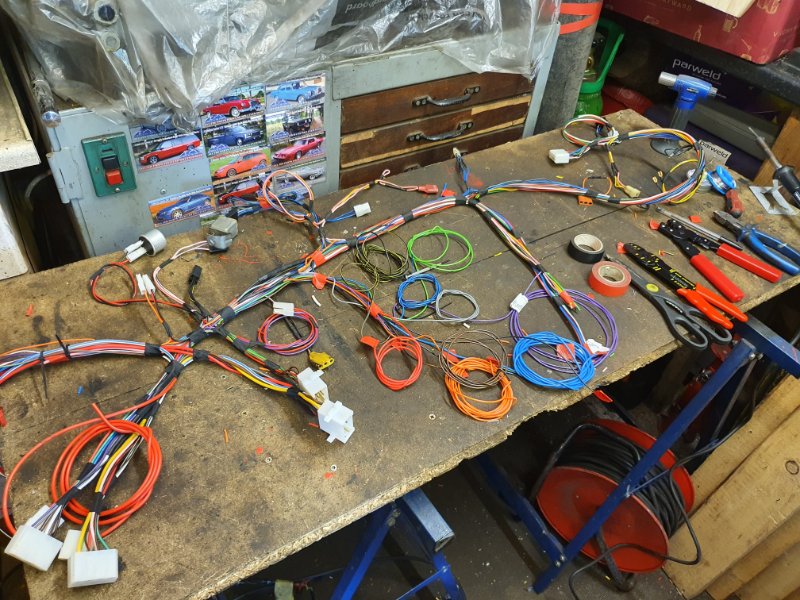

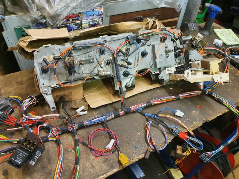

I remade my Charger's loom completely front to rear using what was left of the original and the factory diagram.
Easy enough when you break it into its sections, rear lights, A post to rear, A post & dashboard to bulkhead. Then I did the under hood wiring in situ as that was completely knackered.
Be prepared for it to take a while though, I expect even a premade loom will take some time to fit as well.

ScottyDave wrote: Sun Oct 01, 23 7:12 pm I remade my Charger's loom completely front to rear using what was left of the original and the factory diagram.
Thanks Dave,
You did an excellent job there 👍
I didn't give the amount of space required much thought and I'd probably need to make the harness indoors.
The major issue there is that I have four dogs that will be walking all over it.
I think I need to give this idea a bit more thought!
I could go the painless wiring route but would prefer it to look factory original or close to it!

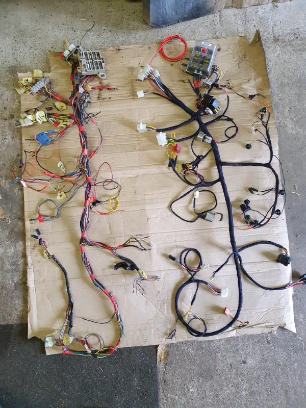

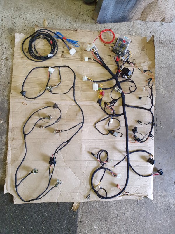

So it turns out that what I thought was from my first Charger was actually from the one I have now and consists of the dash harness and rear harness.
The harness from my first Charger could be in the loft but there's not much chance of finding that anytime soon even if it is in there. Maybe l did chuck it in the boot before the new owner picked it up. It was 16 yrs ago!
So this is what I have to with. I think I could do it but is it worth it?
