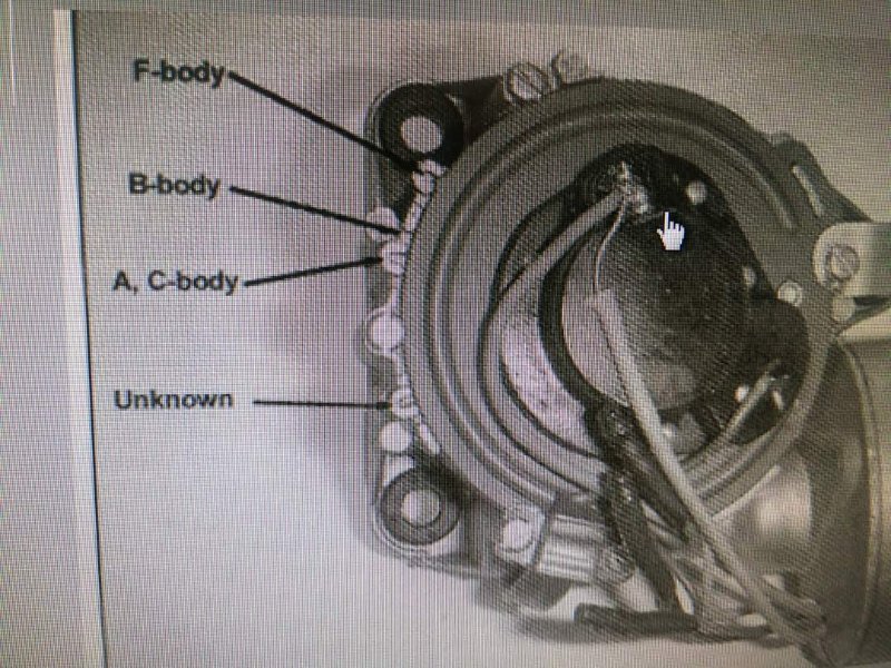

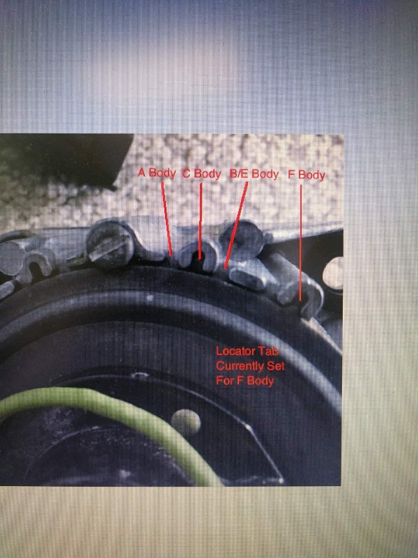

by ScottyDave
1973 Polara motor follow the link below and click "notify when in stock" might take a couple of months but thats how I got mine. You then lift the cover slightly and rotate to the appropriate position to set the park, as in the photos.
