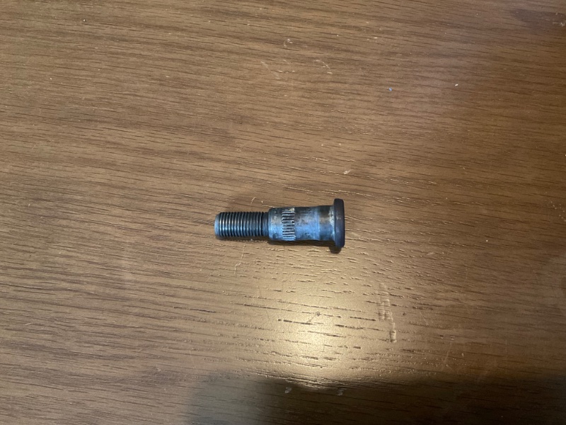

I have been looking for a left hand wheel stud, I found this in a spares box, it looks like a disc brake stud with the extra collar length for the rotor thickness, would anyone be able to say if it is? I’m hoping I’m wrong as I need one for the rear hub drum brake set up.

Yes that’s for a disc brake, the rear studs don’t have that long shank.

Thanks Blue, In the long run I will change the left hand studs over, but I just want to get them all the same on this side at the moment, as the car will probably have at least one inspection when it goes to Australia so I want to prevent confusion and someone accidentally sheering a stud because of the solitary RHD stud on the LH side, .
Using the Dorman product list I believe I've identified the correct stud size, I initially found someone in the States selling LH ones NOS at $2.75 each on the bay, bargain, except shipping was $169! But thankfully someone in Aus was selling a pack of 5 NOS at £28 incl shipping, thank god for those Aussie Valiants.
