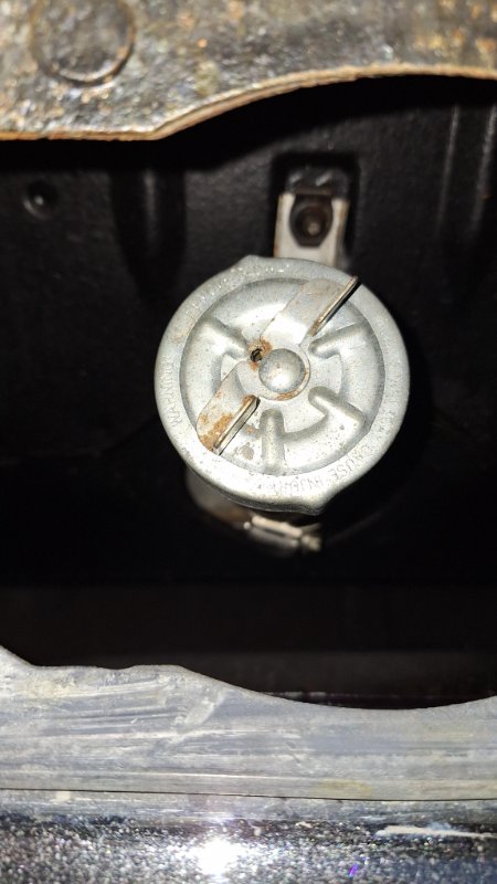

What about your tank cap? reason I ask is I bought a new vented cap before we went to IOM but it seemed to be for venting vapour build up out, not letting air in to prevent a vacuum, luckily I had the original with us and just switched till we got home. Had to drill a small hole in the new one in the end.

Scotty - Yes a vented cap was another item on my list which i forgot to mention. Is it ok to just drill a small hole to let the system breathe? Though the tank vents anyway through the pipe from the sender, through the trunk and then out under the car. Can't help thinking a vented cap wouldn't hurt.
That's all I did since my original cap only had a small hole, IIRC I dismantled the inside before I drilled it.
