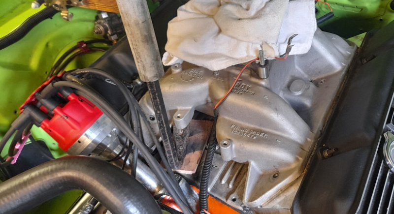

Well after some head scratching and cursing I got there. Not a nice job and I wasn't looking froward to resorting to Pete's method. I started my cutting as much as the silicone as I could. Next was to try and pry the inlet off courtesy of a pry bar with an extended length of piping for additional leverage.
mopar leverage.jpg (72.19 KiB) Viewed 26772 times

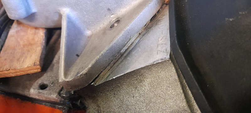

This wasn't working and was absolutely solid. I managed to make a gap the thickness of some flexible sheet tin. Just in the lower corner you can see a crack.

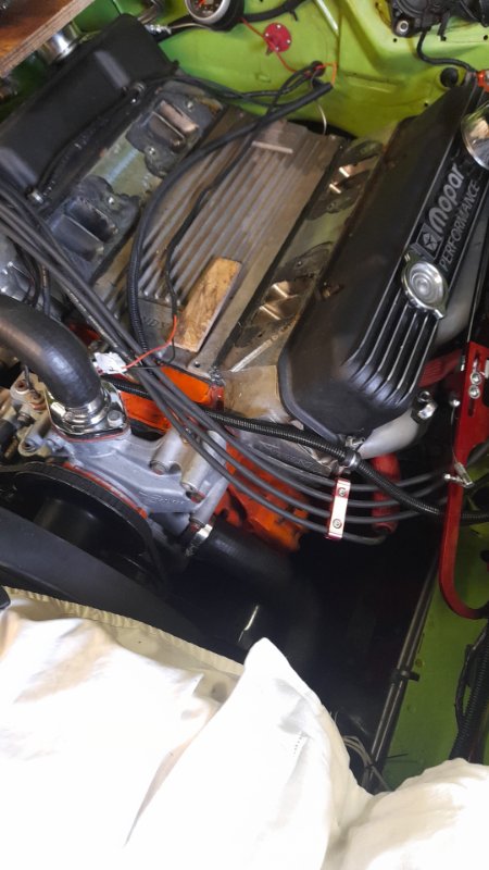

The mazda cill plate was too thick and i had to abondon that. I decided I'd try and shock it off or vibrate it possibly . With a sharp wedged instrument and a few blows with a claw hammer it gave .
mopar heads.jpg (154.4 KiB) Viewed 26772 times
I guess the person who built it didn't use gaskets because my ports are too big. Thanks for suggestions and it cleanup on the silicone tomorrow
