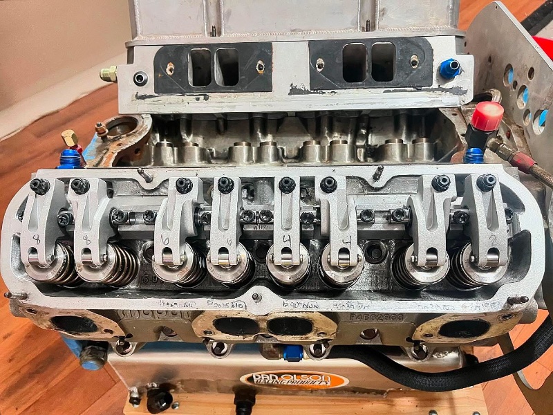

W8 heads are probably the last word in heads for an LA based small block, custom intake, custom headers, custom rocker gear and so it goes on, big power at an eye watering cost
- IMG_2603.jpeg (272.64 KiB) Viewed 22248 times
