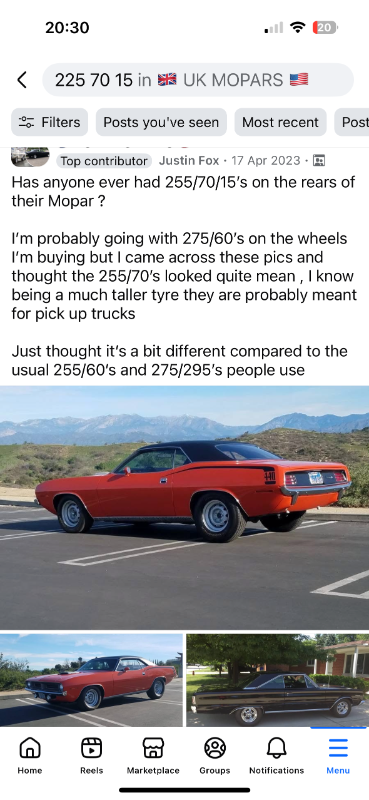

Here’s an ebody with 255/70/15…not my car.
- IMG_2969.png (292.36 KiB) Viewed 46820 times

Thanks for replies,much appreciated.Im up north near Lancaster but thanks for offer to mock up youre wheels.Yes refurb.arch springs ,there is a place in North West that does classics.The 255/70/15s pic is cool,it would create ground clearance for sure but looks too crazy high for me.

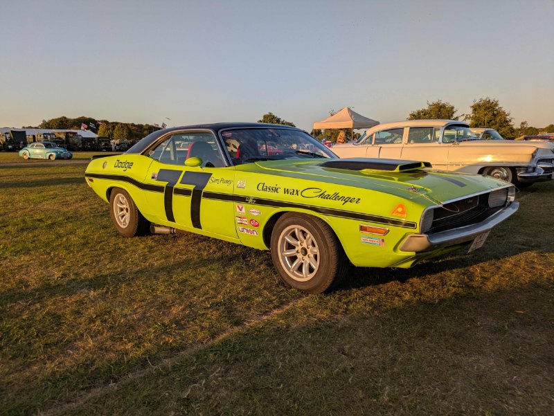

I've got 235/70/15s on the back of my 73 Challenger which is the closest I could get to the T/A size tyre as mine is a 70 TA tribute. I get a tiny bit of rubbing on the outer edge of the arch on the driver's side when loaded with camping gear for Le Mans and going round roundabouts, but otherwise its fine. I think my wheels are 15 x 8 Minator alloys (minilite lookalikes).
My exhausts are genuine T/A boxes with the forward facing side exits pipes, no ground clearance issues and I live in a town with 10 speed humps.
