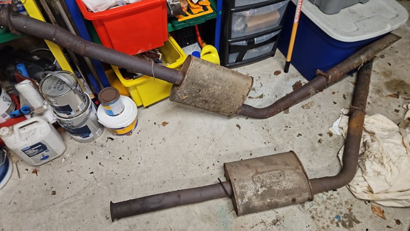

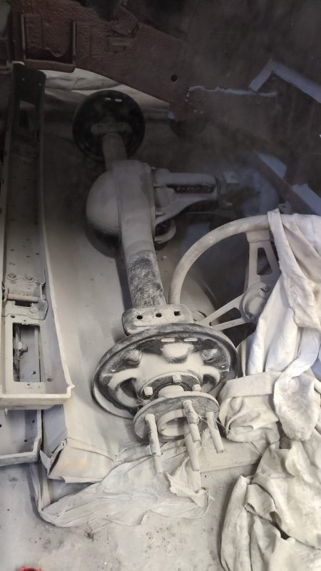

@Dave mentioned this before, I think these came from Brisbane taxi. The axle is more heavy duty than standard.
The pipes are pretty rough so getting rid.

The axle is an 8.75, 742 centre section with 4.10s and a clutch type lsd. Spring perches inboarded for the VE tubbed rear but might have been redone for the VF if not tubbed.

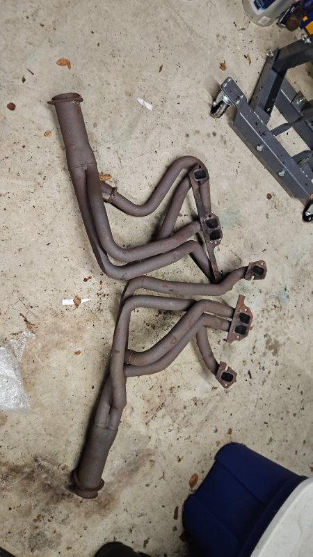

Extractors were Hedman. I fabricated the drivers side to fit RHD, a labour of love! Not sure what's going on near the collector on the passenger side.
Exhausts were just some pipe bent up at Pipecraft.
