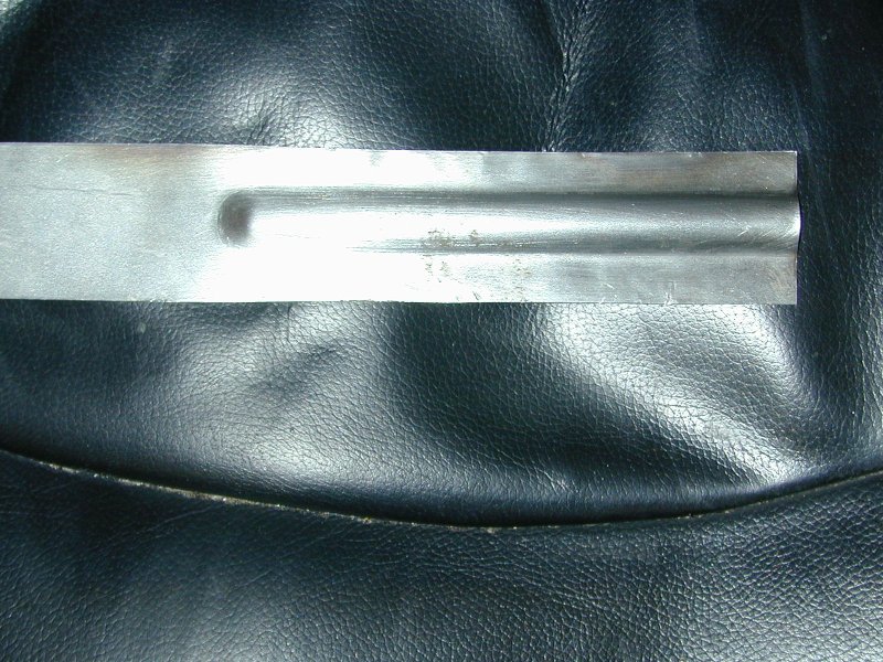

I've also tested a simple tool I made up to press in some ribs where needed and that seems to work OK (with a bit of dolly work afterwards).

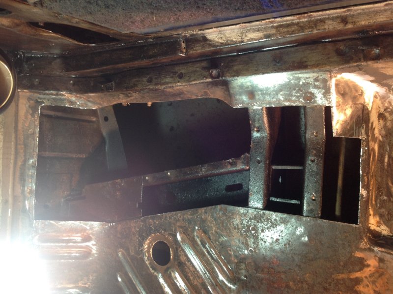

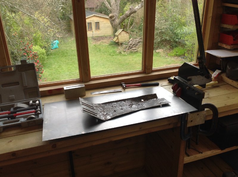

So, that's the bad bit out
Floor 7.jpg (115.85 KiB) Viewed 3978 times

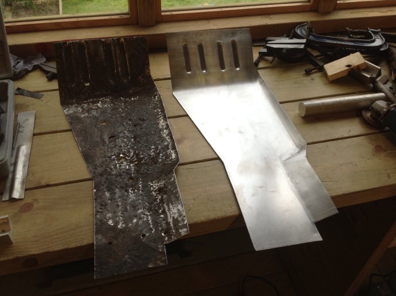

Best make a new bit...
Floor 9.jpg (104.67 KiB) Viewed 3978 times

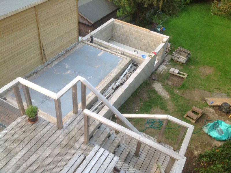

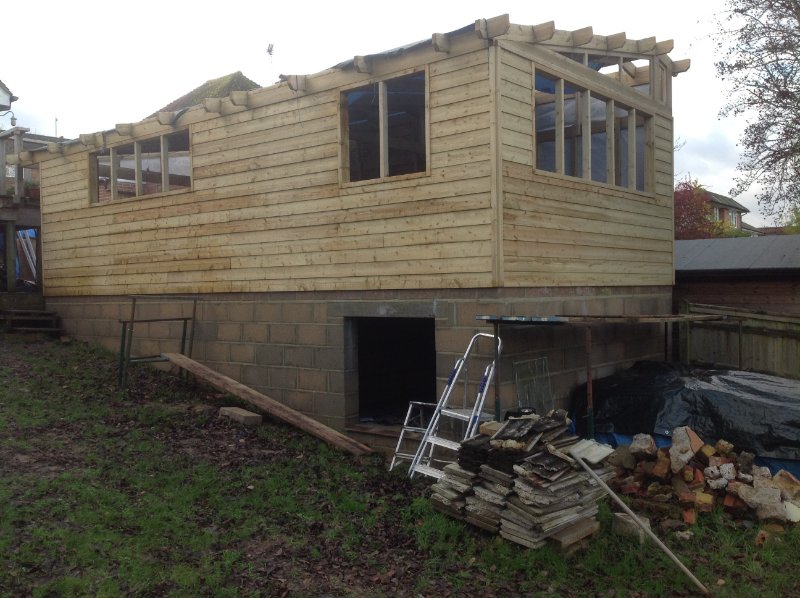

That is the extended version ! Thanks to the slope we're on it's already nearly a storey above ground at the back...
Re: Dom's 66 Coronet 500
Posted: Fri Apr 03, 20 7:58 am
by Captain Chaos
That’s lovely. Room underneath for stuff tooπŸ‘

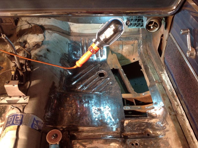

Posted: Fri Apr 03, 20 6:09 pm

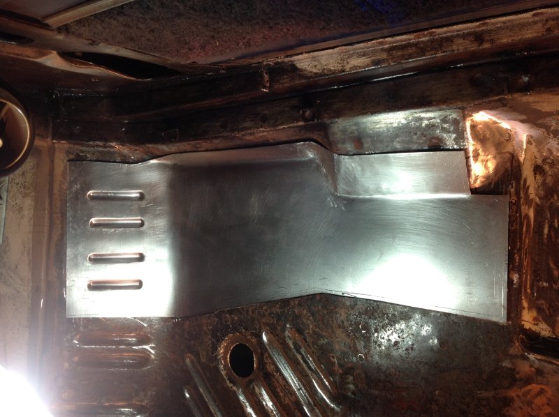

Got a wire brush and some rust converter as far up the exposed sections as I could, I'll hit it with some weld-through primer before zipping it up.
Floor 12.jpg (103.49 KiB) Viewed 3942 times
Got pretty close with the new patch...
Floor 15.jpg (74.79 KiB) Viewed 3942 times
It'll just need a final trim to fit.
Floor 13.jpg (96.69 KiB) Viewed 3942 times

Dom66 wrote: Fri Apr 03, 20 7:52 am
mygasser wrote: Thu Apr 02, 20 10:37 pm
Captain Chaos wrote: Thu Apr 02, 20 8:43 pm Nice view,very relaxing πŸ‘
that's true and so much room to extend the garage too :thumbright:
ooh! machine shop under the garage then. plenty of room (and ventilation) in the 'pit' then. :thumbright:

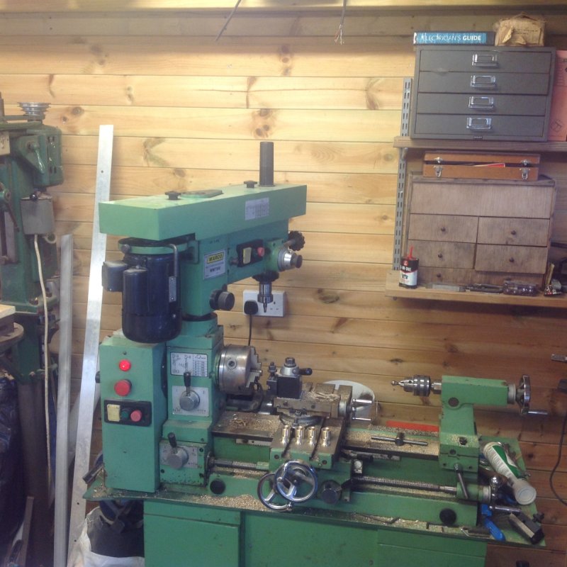

Underneath is a good store, but not quite high enough to stand up properly. 'Machine shop' is upstairs though...
