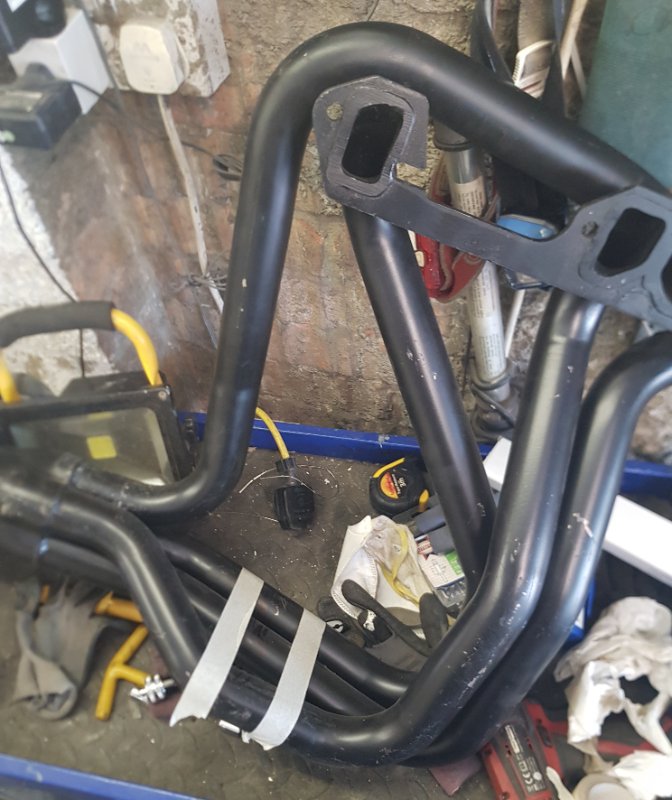

Ah, the joys of aftermarket headers!
Engine needs to be tilted to get the nearside fitted, and if I ever want to change the rear spark plugs, it will have to come off :cry:
And the drag link fouls it enough for some 'relieving' to be required.....some subtle mods in the area between the tape :twisted:

No surprises there.
Try a big block or a Hemi if you really wish to enter a world of pain.
Most of installation is learning the sequence of installation, where most often the Pass side header goes on first due to less clearance as a result of the engine off-set.

The thing with headers is the engine needs to sit in the car level side to side. Often the position it naturally wants to sit is on the tilt, a certain amount of jacking about is often needed to force it the sit straight before you bolt the mounts up.

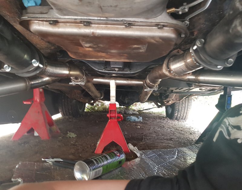

Engine in for hopefully the last time, headers now clear everything they should. The job I dreaded was making up a temporary header exhaust fix. The Belv had a gorgeous 2.5" stainless system with cut outs, but of course the 360 headers exit in different places, and aren't symmetrical.
A couple of feet of stainless flex and lots of adjustment and measuring and it's in. Not pretty, but more than good enough to get everything running and then visit a proper exhaust workshop to get some new sections made up.

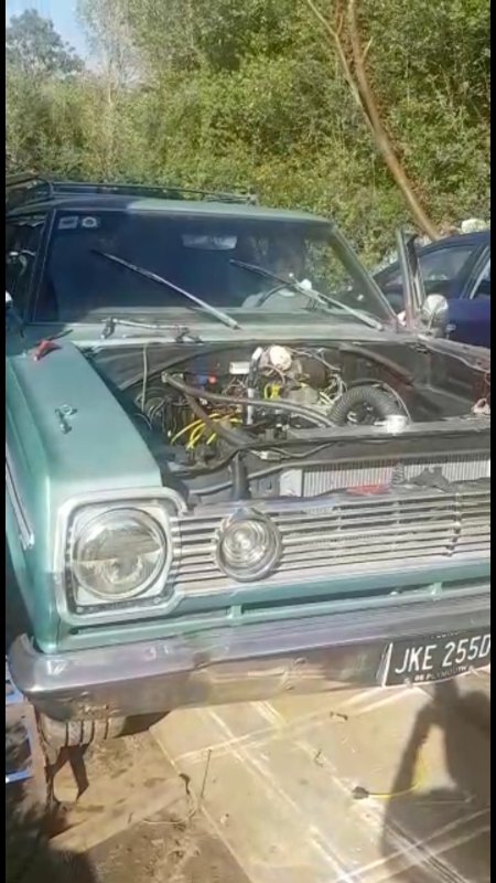

YESSSSS!
Some troubleshooting, and it started on the first turn of the key! Scared the life out of me as I wasn't expecting it, so turned it off quickly :shock:
A few jobs round the edges to finish off, then cam run in at the weekend :thumbright:
Dull picture, but I'm smiling and wooping in the driver's seat!

Well done!
Hope the Cam run-in "Pucker Time!" goes well!!!
