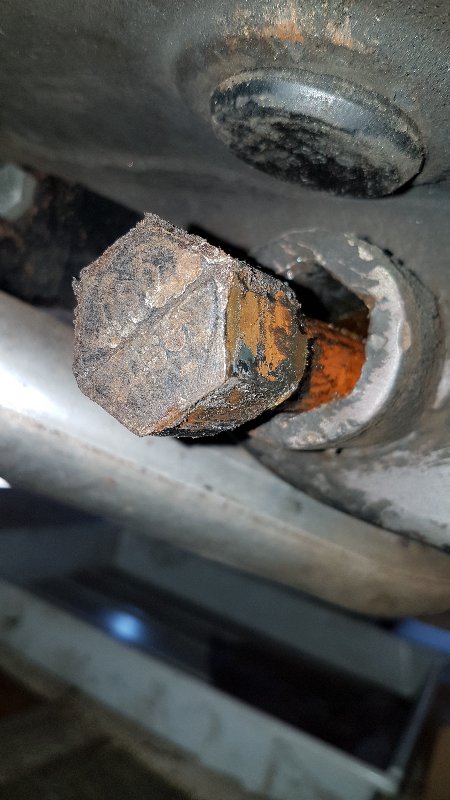

So, I've read about as much as I can find online about refurbishing the front suspension and made a start yesterday.
Everything was coming apart nicely until I got to the torsion bar. It doesn't appear to have the circlip in the rear mount. The pic shows the rear mount. Is this where the clip should be? Is so, and it is missing, what's holding it in?
Re: Front end rebuild question
Posted: Fri Jan 26, 18 5:36 pm
by Pete
It is being held in with the load on it imparted by the Control Arm.
In reality you need a Torsion bar removal tool to do it properly, but if you are lucky you can use a pry bar on the Lower control arm to get things moving.
If you look carefully you will see there is a groove for the Circlip at the back of the housing on the Gearbox Cross member.

by freighdog
Thanks Pete, I did think the grooves were for the clip. The mount looks a bit battered, hopefully they've not peened it over to hold the bar in.

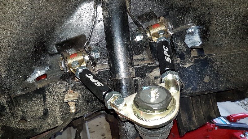

YAY!!
Thanks to all you help and advice, and a little persuasion from 'The Persuader', one side is mostly done.
New UCA is in, LCA is undergoing a rebuild.

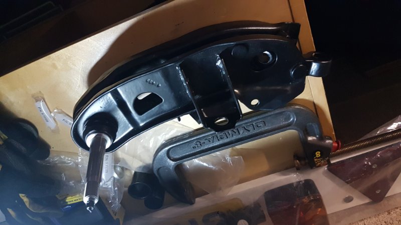

by freighdog
Lovely refurbished lca with new pivot pin and bush, ready to go in.

by morgan
Lovely job.
Next time you take the torsion bars out it will be easy. I had to take the new ones out to do a starter motor recently and once I took the tension out they slid out by hand. Keep the pics coming
